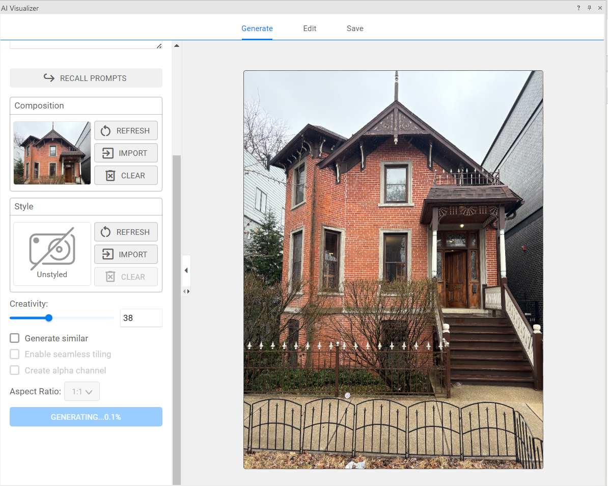

Dan Menitoff Posted March 26, 2025 Share Posted March 26, 2025 I'm having the same issue. first time I tried the generate button just sits and spins saying 'Queued'. I tried multiple times and even slid the 'Creativity' slider down to single digits and nothing happens. I updated to latest version: VW 2025 Update 4. And now instead of the 'Queued' button it is stuck on 'Generating...0.1%' and just sits with what seems like nothing happening. Anybody have any advice? Quote Link to comment
Vectorworks, Inc Employee Dave Donley Posted March 26, 2025 Vectorworks, Inc Employee Share Posted March 26, 2025 Hello @Dan Menitoff Are you using a beta or NFR serial number or account? We have been patching up cases where NFR users have non-functional AI Visualizer generate, because of mismatches in their serial and account for VSS/subscription. This feature requires subscription or VSS account, an alert box should show when using the Model/AI Visualizer menu item if that is the case, if you are getting into the UI then it thinks you do have subscription/VSS. You might try signing out of Vectorworks with the upper-right signout option, and relaunch Vectorworks, signin again, then try the AI Visualizer. Quote Link to comment
