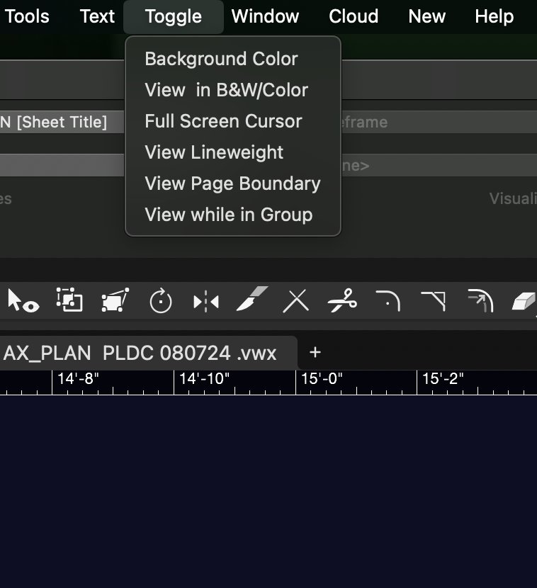

Ian Graham Posted September 10, 2024 Share Posted September 10, 2024 (edited) TOGGLE drop down menu . Used it al the time for plug ins like background colour , view line weigh etc switching quickly ? Edited September 10, 2024 by Ian Graham added screenshots Quote Link to comment
0 Vectorworks, Inc Employee Rob Nykolaishen Posted September 11, 2024 Vectorworks, Inc Employee Share Posted September 11, 2024 @Ian Graham That is not a standard Vectorworks menu item, this looks to be an old third party plug-in 1 Quote Link to comment
0 Ian Graham Posted September 13, 2024 Author Share Posted September 13, 2024 On 9/11/2024 at 7:42 PM, Rob Nykolaishen said: @Ian Graham That is not a standard Vectorworks menu item, this looks to be an old third party plug-in Was using it in vwx 2024 , don;t think I added teh menu items , did add the plug ins , super helpful drop top menu . Hmm , have to fin a way to make it work . Any suggestions ? Ian Quote Link to comment

0 Ian Graham Posted September 14, 2024 Author Share Posted September 14, 2024 20 hours ago, Tom W. said: I thought this sounded familiar... I did input the Plug ins form previous version , and worked in vix 2024 , under Toggle drop down . My question there is not toggle top top own in vex 2025 . I also looked in my plug ins to see if that was the missing part ? No toggle menu bar plug in Quote Link to comment
0 Ian Graham Posted October 13, 2024 Author Share Posted October 13, 2024 On 9/11/2024 at 7:42 PM, Rob Nykolaishen said: @Ian Graham That is not a standard Vectorworks menu item, this looks to be an old third party plug-in Is there a work around to create the drop down menu with the plug ins ? Is such a helpful function . Open to any suggestions . Thanks ian Quote Link to comment

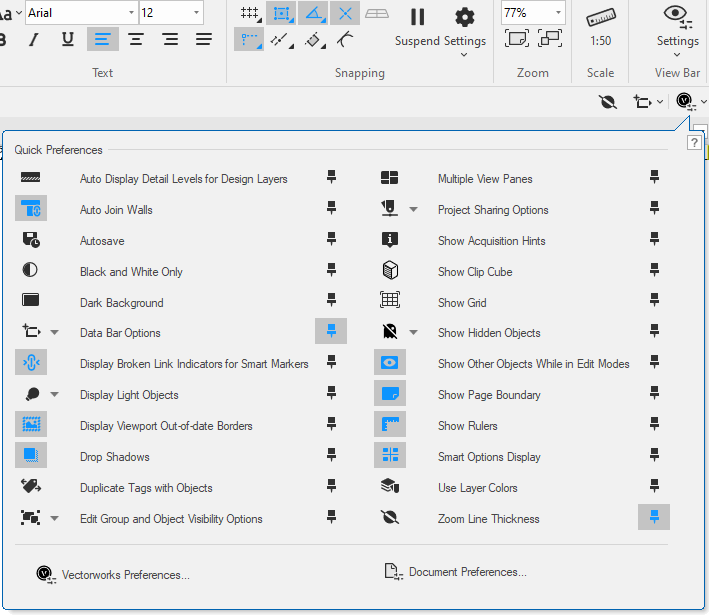

0 rDesign Posted October 13, 2024 Share Posted October 13, 2024 Have you made use of the Quick Preferences menu? You can add / pin these preferences to the Tool bar — and since they are a single-click toggle they would be quicker to use than that third-party pull-down. Vw2025 User Guide - Setting Quick Preferences Quote Link to comment
