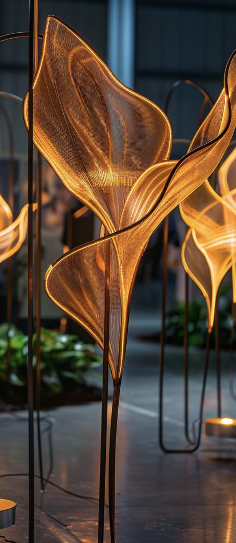

suz Posted July 31, 2024 Share Posted July 31, 2024 Hello! Can someone help me create this exact shape? the two petals and the metal frame? Thank you! S Quote Link to comment
Diego - Resuelvector Posted July 31, 2024 Share Posted July 31, 2024 You will need to use several NURBS curves to achieve that or a play with subdivision modeling Quote Link to comment

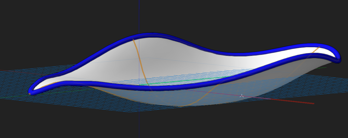

VIRTUALENVIRONS Posted July 31, 2024 Share Posted July 31, 2024 @suz Sux....I wrote you a 9 minute tutorial how to get this done. Did you watch it. 1 Quote Link to comment
VIRTUALENVIRONS Posted July 31, 2024 Share Posted July 31, 2024 This was made without the use of NURBS curves until the very end where an extraction was used to create the border. Time to make it 3 minutes. 1 Quote Link to comment

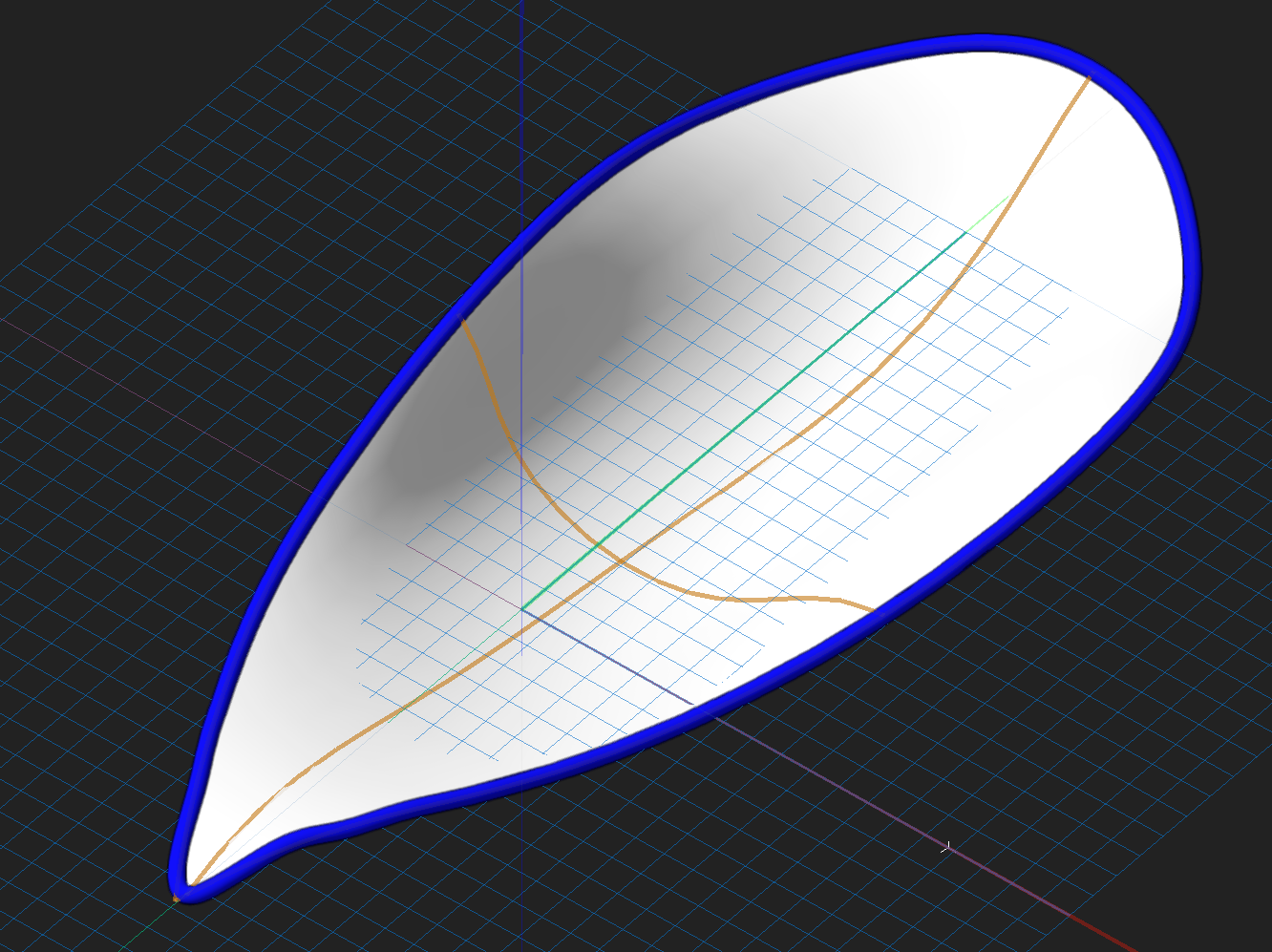

VIRTUALENVIRONS Posted July 31, 2024 Share Posted July 31, 2024 @suz This is another way to it, there are many. The new tool I am introducing is the Contours tool. Look it up, but this is an easy way to do it with NURBS curves. 2 Quote Link to comment

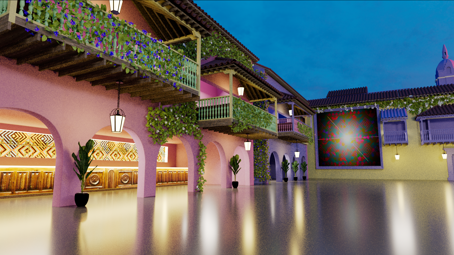

grant_PD Posted July 31, 2024 Share Posted July 31, 2024 I recently had to go there... 2 Quote Link to comment

VIRTUALENVIRONS Posted August 1, 2024 Share Posted August 1, 2024 @grant_PD. Beautiful work and rendering. Is this all done in Vectorworks? Quote Link to comment
grant_PD Posted August 1, 2024 Share Posted August 1, 2024 @VIRTUALENVIRONS all built in vectorworks. The flowers and plants are a neat little plug in for C4D. Each leaf and flower are 3d polys that "grow" from a hand doodled vine. I believe it's using the mograph functionality for c4d. I really wish vectorworks had something akin to mograph for c4d. Quote Link to comment
VIRTUALENVIRONS Posted August 1, 2024 Share Posted August 1, 2024 @grant_PD It looks very realistic. It probably has "roots", no pun intended in Mograph. I only have C4D 20. What version are you using? Quote Link to comment
grant_PD Posted August 1, 2024 Share Posted August 1, 2024 @VIRTUALENVIRONS R26 or whatever the latest is? Quote Link to comment
VIRTUALENVIRONS Posted August 1, 2024 Share Posted August 1, 2024 I@suz From you original image, I think I was able to parse out what you want to do. Hopefully, you have completed your task. IF not, Included is the file with the construction curves that constructs the objects in the video. S-2.vwx 1 Quote Link to comment
