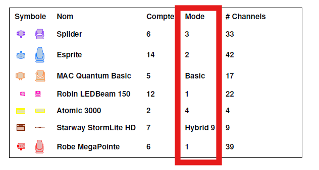

Enzo Vernusse Posted July 14, 2024 Share Posted July 14, 2024 Hello everyone, I would like to know if it was possible to display the projector installation mode when I create a symbol legend? How it is possible to do on Wysiwyg. (image below) Quote Link to comment
Vectorworks, Inc Employee Scott C. Parker Posted July 15, 2024 Vectorworks, Inc Employee Share Posted July 15, 2024 The Equipment Summary Key tool shows the GDTF mode when you add the Plug-In version of the symbol. 1 Quote Link to comment
Enzo Vernusse Posted July 15, 2024 Author Share Posted July 15, 2024 Sorry but when activating GDTF mode nothing appears, can you show me the object info palette of your fixtures please? Quote Link to comment
Enzo Vernusse Posted July 15, 2024 Author Share Posted July 15, 2024 Impossible to edit the GDTF mode of my fixtures in the object info palette... Quote Link to comment
UriAK Posted July 21, 2024 Share Posted July 21, 2024 Hi Enzo, I use to download all the GDTF needed and import them to my project File > Import > Import GDTF... Then you can go to the fixture OIP (Object Info Palette), GDTF Fixture > Other... and assign the correct one. Doing this you will have some advantages, and I think you will solve your problem. Cheers! 1 Quote Link to comment
