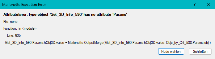

i tested the node on my system and it doesn’t seem to work properly.
If I open the node and then recompile it by clicking OK, the node works without any problems. However, I must open it first.
I haven’t done any further tests to see if the node remains stable when placed in a wrapper, or if reopening is necessary after a restart, etc.
Additionally, I don’t know if other users who use the script but have never opened the node will still encounter an error.

If the issue is resolved on your computer by opening and closing the node's script when it's placed on the drawing area, then a fix would be to navigate to the Marionette Default Library.vwx file, edit the 'Get 3D Info' Symbol in the Resource Manager, enter and exit the script there, and save the vwx
I'm looking into why this is still an issue, but it seems like when an update to the python scripts (which are stored separately from the vwx) was made, the symbol for whatever reason didn't get refreshed with our update script.
Editing to add:
How we typically update Marionette nodes is to edit the python file and then run a script to push the update to the existing nodes within the vwx file to sync them up. Each time you open a Marionette node's script in the script editor, it reaches out to the referenced file and pulls from there which is why opening/closing the node fixes the issue.
