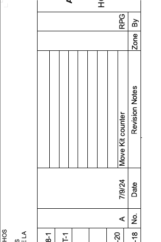

Ramon PG Posted July 9, 2024 Share Posted July 9, 2024 (edited) Hi, I know how to use Revisions and make a report, but the Revision will not appear in the Project Revision History worksheet. also... is there a way to link the revision cloud in the drawing to the Revision Notes? also... Revision in the Title Block are in letters and revision bubbles tool only shows numbers. Thanks. Edited July 9, 2024 by Ramon PG Quote Link to comment
0 Vectorworks, Inc Employee Nikolay Zhelyazkov Posted July 10, 2024 Vectorworks, Inc Employee Share Posted July 10, 2024 Hello @Ramon PG, 13 hours ago, Ramon PG said: I know how to use Revisions and make a report, but the Revision will not appear in the Project Revision History worksheet. - Are you talking about revisions created from one of the title block border dialogs? 13 hours ago, Ramon PG said: is there a way to link the revision cloud in the drawing to the Revision Notes? - Currently not. 13 hours ago, Ramon PG said: Revision in the Title Block are in letters and revision bubbles tool only shows numbers. - You can set up revisions in the title block to use numbers too from the document options pane in the manager or settings dialogs. Best Regards, Nikolay Zhelyazkov Quote Link to comment
0 Ramon PG Posted July 19, 2024 Author Share Posted July 19, 2024 On 7/10/2024 at 1:16 AM, Nikolay Zhelyazkov said: Hello @Ramon PG, - Are you talking about revisions created from one of the title block border dialogs? YES - Currently not. OK - You can set up revisions in the title block to use numbers too from the document options pane in the manager or settings dialogs. THANKS Best Regards, Nikolay Zhelyazkov Quote Link to comment
0 Vectorworks, Inc Employee Nikolay Zhelyazkov Posted July 21, 2024 Vectorworks, Inc Employee Share Posted July 21, 2024 @Ramon PG The Project Revision History is a report about issues. It reports the current revision of each issue in the document. So in order to have any data in it you need to have both issues and revisions. Maybe you do not have issues in your document? Quote Link to comment
