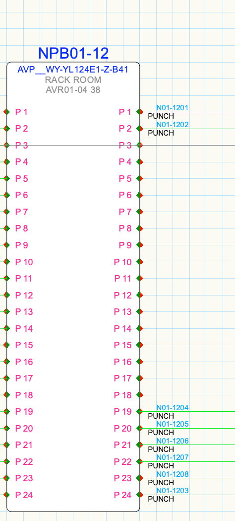

AudioEngiNerd Posted July 15, 2024 Author Share Posted July 15, 2024 Another thing that I have already run into is that I am not necessarily using every port on a patch bay or switch so if there is a way to ensure that the last digit matches the number of the port that it is plugging into that would be great. Quote Link to comment
Vectorworks, Inc Employee Conrad Preen Posted July 17, 2024 Vectorworks, Inc Employee Share Posted July 17, 2024 Hi @AudioEngiNerd Have a look at how this sample numbering system works. We look for device names with a prefix that indicated a patch panel and grab the suffix to be part of the circuit number. All this is quite well explained in the online help. Conrad Quote Link to comment
