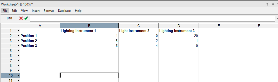

tdlx Posted July 2, 2024 Share Posted July 2, 2024 Hi, Apologies if this has been covered, I've looked through several worksheet posts and can't seem to find a solution. I'm trying to create a worksheet that lists the lighting positions in rows, and the instrument type across the columns. I can populate the headers / position names manually if necessary, but working out how to do the counts I'm getting stuck on! Any help greatly appreciated! Many thanks, Tom Quote Link to comment

Pat Stanford Posted July 5, 2024 Share Posted July 5, 2024 @TomWhiteLight Can you clarify please? A Worksheet Database certainly can't do what is being asked for but I think you can accomplish it with Spreadsheet cell formulas. Since the Lighting Device record contains both the Instrument Type and the Postion, you can use a complex criteria with the Count function to get the data directly from the Lights. In my test file I listed the Position Names in Column A and the Instrument Types in Row C. By using a $ in the cell reference in the formula you can force it to use an absolute Row or Column reference so when you copy and paste the formula it will still work. The formula I came up with is: =COUNT(('Lighting Device'.'Position'=$A7) & ('Lighting Device'.'Inst Type'=B$6)) But I know almost nothing about lights and positions, so I could have this completely wrong. 2 Quote Link to comment
Vectorworks, Inc Employee TomWhiteLight Posted July 8, 2024 Vectorworks, Inc Employee Share Posted July 8, 2024 Thanks @Pat Stanford any chance you can post the worksheet. I knew this was not possible using the worksheet database but I have never tried then editing the worksheet criteria. Quote Link to comment
Pat Stanford Posted July 8, 2024 Share Posted July 8, 2024 The "good" part of the worksheet is rows 6-10. Above that was when I was still trying to use a database. This would be tedious to set up for hundreds of positions and instrument types, but it should work. Count Pos and Inst Type.vwx Quote Link to comment

Vectorworks, Inc Employee TomWhiteLight Posted July 9, 2024 Vectorworks, Inc Employee Share Posted July 9, 2024 Pretty solid, obviously have to update the position and instrument type names but its great! 1 Quote Link to comment
