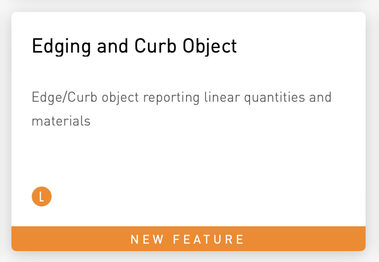

Tom W. Posted July 1, 2024 Share Posted July 1, 2024 You could use Duplicate Along Path or even create a Line Type but I think ultimately you're going to want to place them individually as won't you need shorter lengths on the tight bends + mitred joints...? I don't think the Fence Tool is going to help as that's really a 3D tool with limited control over what you see in 2D. In future there will be this however: Quote Link to comment
