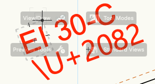

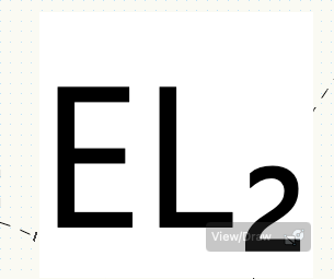

fips Posted February 9 Share Posted February 9 As so often, you find an issue that is 20+ years old... I need to import a couple dwgs and the fonts are all messed up. Most is just a size issue, but there seem to be encoding issues too. what the dwg is looking like: after import in vw: to double check, that I have the font installed, I can paste this in a text editor on my system: now to insanity: when I enter the unicode char in Vectorworks manually it works Any idea how to fix this? Kind regards Quote Link to comment
