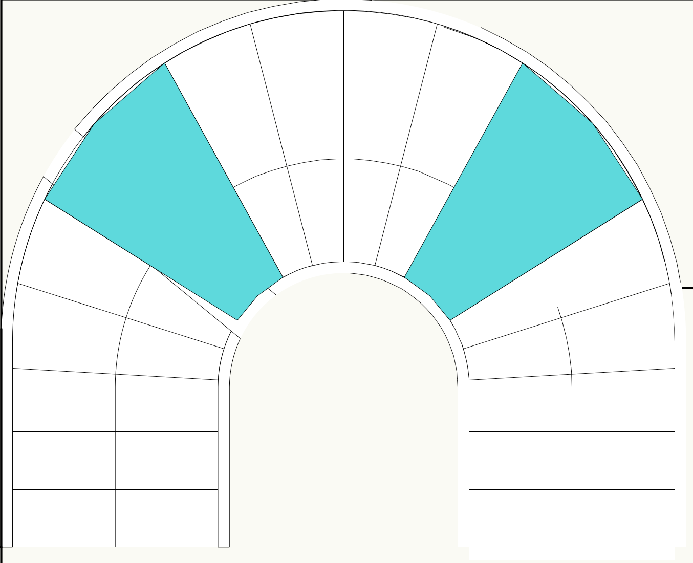

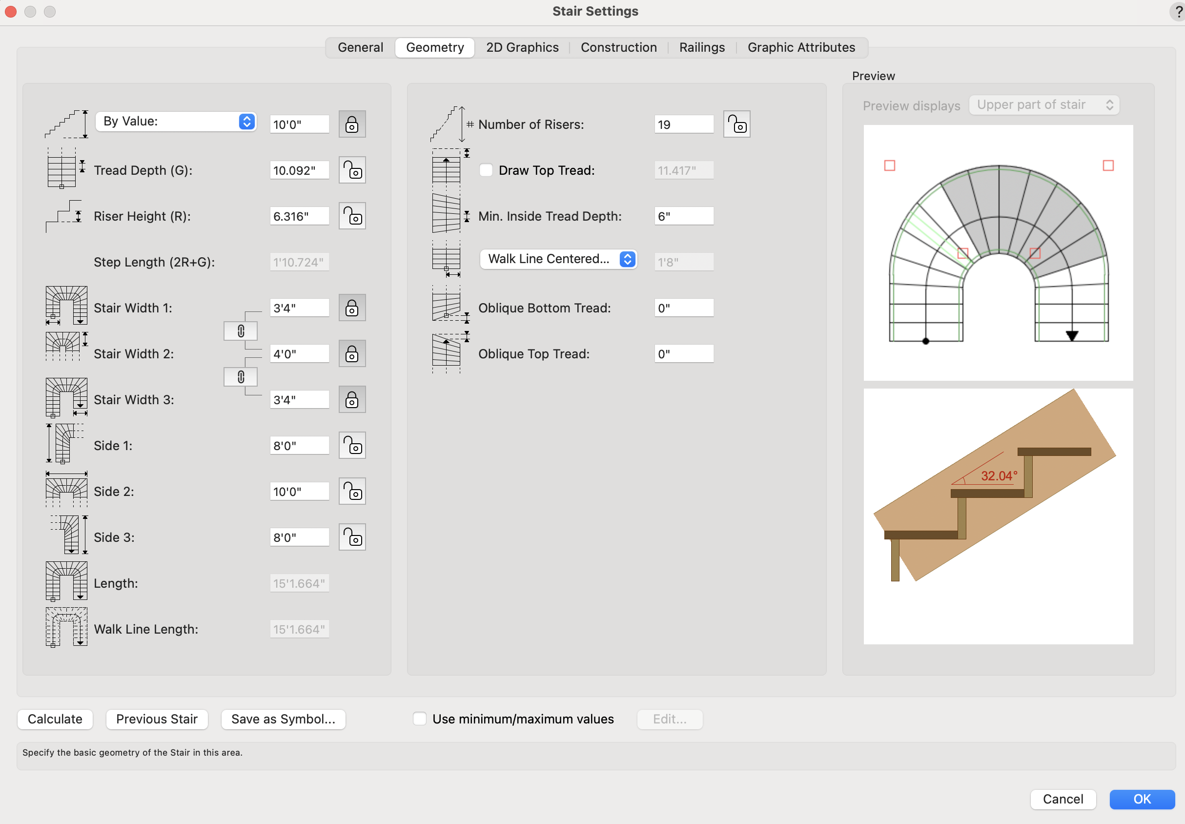

Positive Space Design Posted June 19, 2024 Share Posted June 19, 2024 (edited) Hello, I have attached a screenshot of a stair i'm developing. I want to add 2 intermittent landings in the curved section of the stairs, screenshot attached with the landings in blue, in the OIP I do not see an option for adding a landing. Neither in the Geometry, Genereal or Construction tab. Is anyone familiar with this design challenge? Thank you! Edited June 19, 2024 by Positive Space Design addtional info Quote Link to comment

taoist Posted June 20, 2024 Share Posted June 20, 2024 What about the Custom Stair tool? Quote Link to comment
DBrown Posted June 20, 2024 Share Posted June 20, 2024 The stair has a ton of features, but flexibility is not one of them, if you want to do a great stair, don't use the Stair tool of Vectorworks, model your own, but take into account you will spend several hours doing so 2 Quote Link to comment
Positive Space Design Posted June 20, 2024 Author Share Posted June 20, 2024 Thanks all for your comments. I figured I would need to either build a custom stair or model it from scratch. Quote Link to comment
