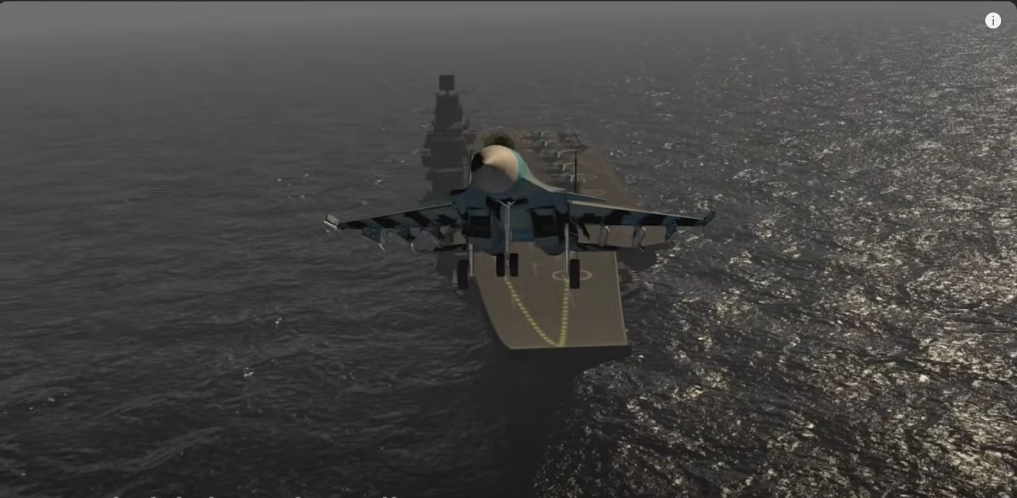

VIRTUALENVIRONS Posted June 16, 2024 Share Posted June 16, 2024 (edited) Water is a rather unique element. One, it's look changes with the height it is viewed from, lighting and reflections as pointed out by @Claes Lundstrom. But, it also loves highlights and this is a refraction thing. Depending on the turbidity of the water, light may or may not penetrate. As you will have a lot of grey water, your turbidity level will be high and relatively flat surface. The good news is, your pond should be just high reflective of the surrounding terrain and a slight bump. In the image below water changes based on objects in the scene, height it is views from, refraction etc. Mastering water is a trial and error process. Edited June 16, 2024 by VIRTUALENVIRONS 1 Quote Link to comment
