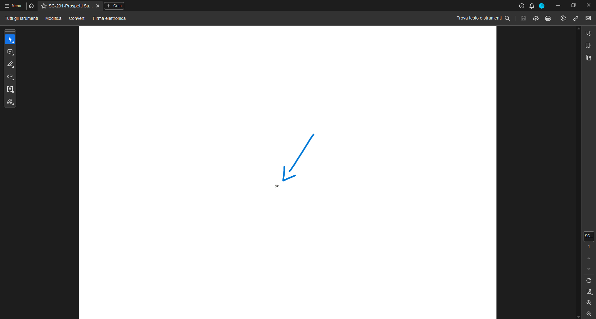

I have a problem with a file we have been working on during the last six months and that now looks corrupted.
This is the situation:
Issue:

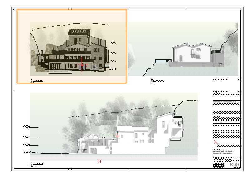

We have several Sheet Layers with elevation viewports from a quite large and complex bim model.
When exported, they are shown in pdfs as very small, indipendently by page size, there are no far objects.
see screenshots below to understand what I mean:
Original Sheet Layer (screenshot in VW):
Exported PDF (both with publish command or export/pdf):

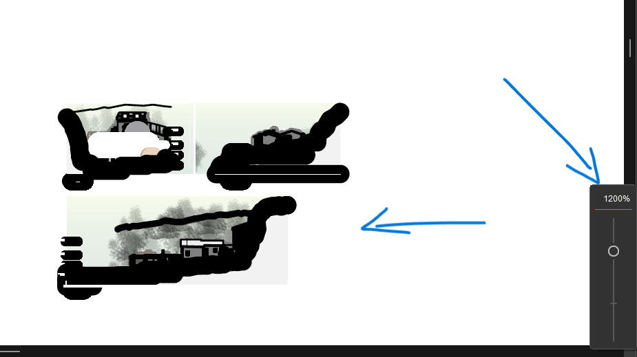

Zoomed pdf:

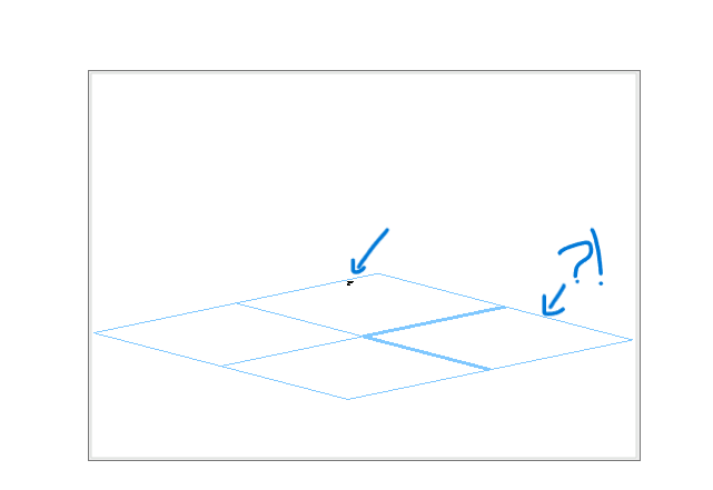

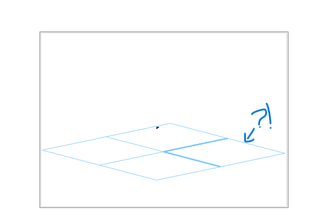

Sheet Layer in Vectorworks after the pdf has been exported (this is the most strange part) a 3d space is visualized within the sheet layer, the small dots are the three viewports:
