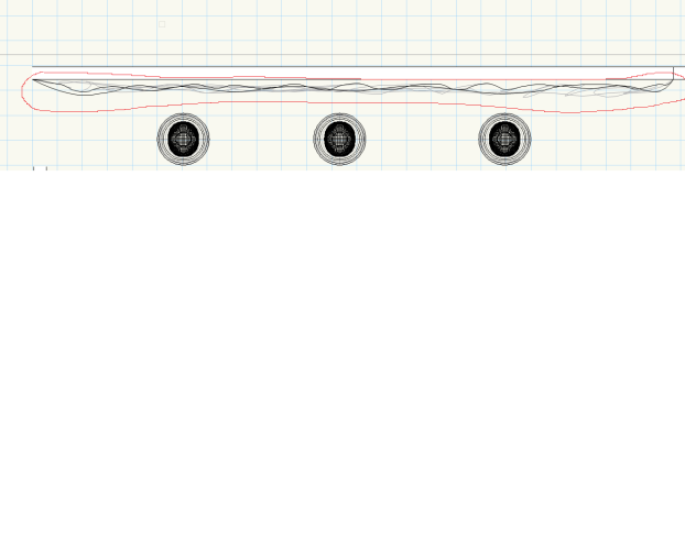

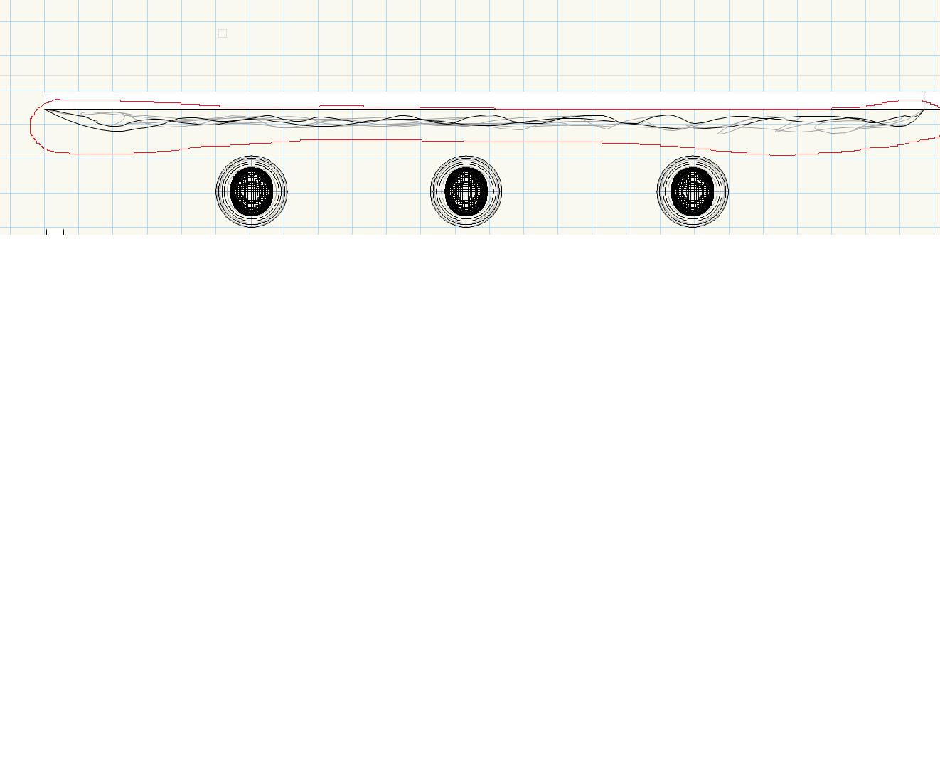

Kevin Huynh Posted June 10, 2024 Share Posted June 10, 2024 Greetings, I created a nurbs surface with the loft surface tool but now I'm stuck figuring out how to close it because I'd like to subtract solids from it as well. Also, I couldn't use the shell solid command on this nurbs surface. Any ideas on how to approach this? Quote Link to comment

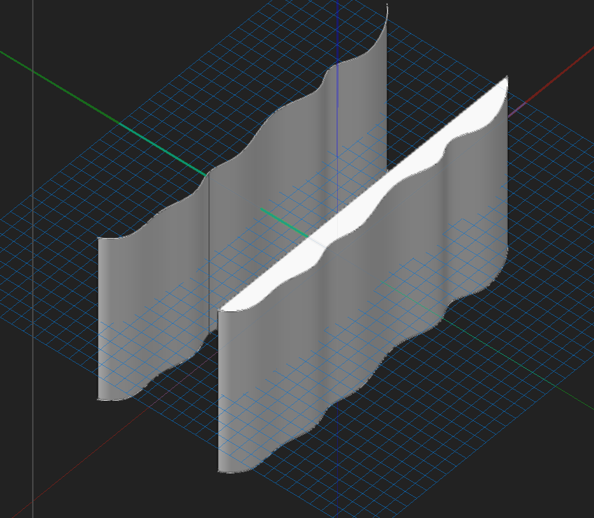

VIRTUALENVIRONS Posted June 10, 2024 Share Posted June 10, 2024 9 hours ago, Kevin Huynh said: I'm stuck figuring out how to close I think I know what you mean, but maybe not. There are two images below, is the one on the right something like what you are trying to achieve. Quote Link to comment

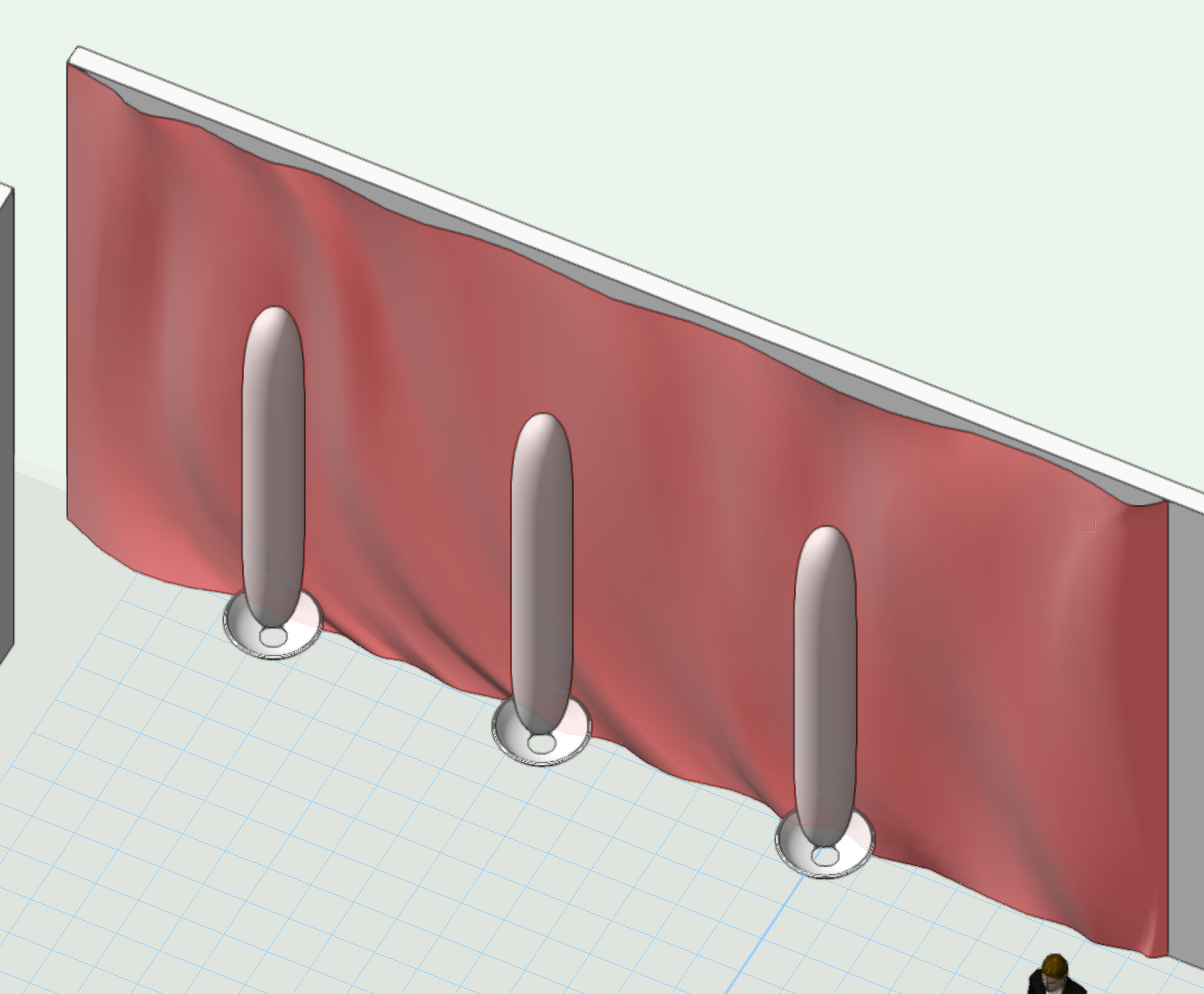

VIRTUALENVIRONS Posted June 10, 2024 Share Posted June 10, 2024 I think I know what he is trying to do. His model is a curtain for lack of a better explanation. I think when he says "close", he means close as in a closing a 2D polygon. Then he would have a solid after he lofts. This is easy enough for a NURBS curves, but it is time to hear from the original user what he needs. Posting the file would be good. Quote Link to comment

VIRTUALENVIRONS Posted June 13, 2024 Share Posted June 13, 2024 3 hours ago, Kevin McAllister said: If all that's required is some holes in the NURBS surface, the Project tool is the right tool for the job. Hi Kevin No one is quite sure what this fellow is trying to do, as he won't tell us. 1 Quote Link to comment
