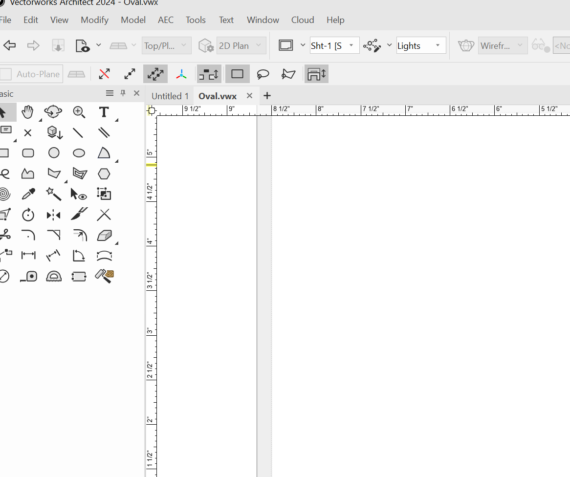

I'm using VW 2024 on Windows 10, and am trying to have multiple projects visible on my screen open at the same time (so I can reference one while working on the other). Is there an option within VW that enables this?
In other programs, like Photoshop, I can undock the project tabs and look at multiple windows at the same time. Hoping for something like that.

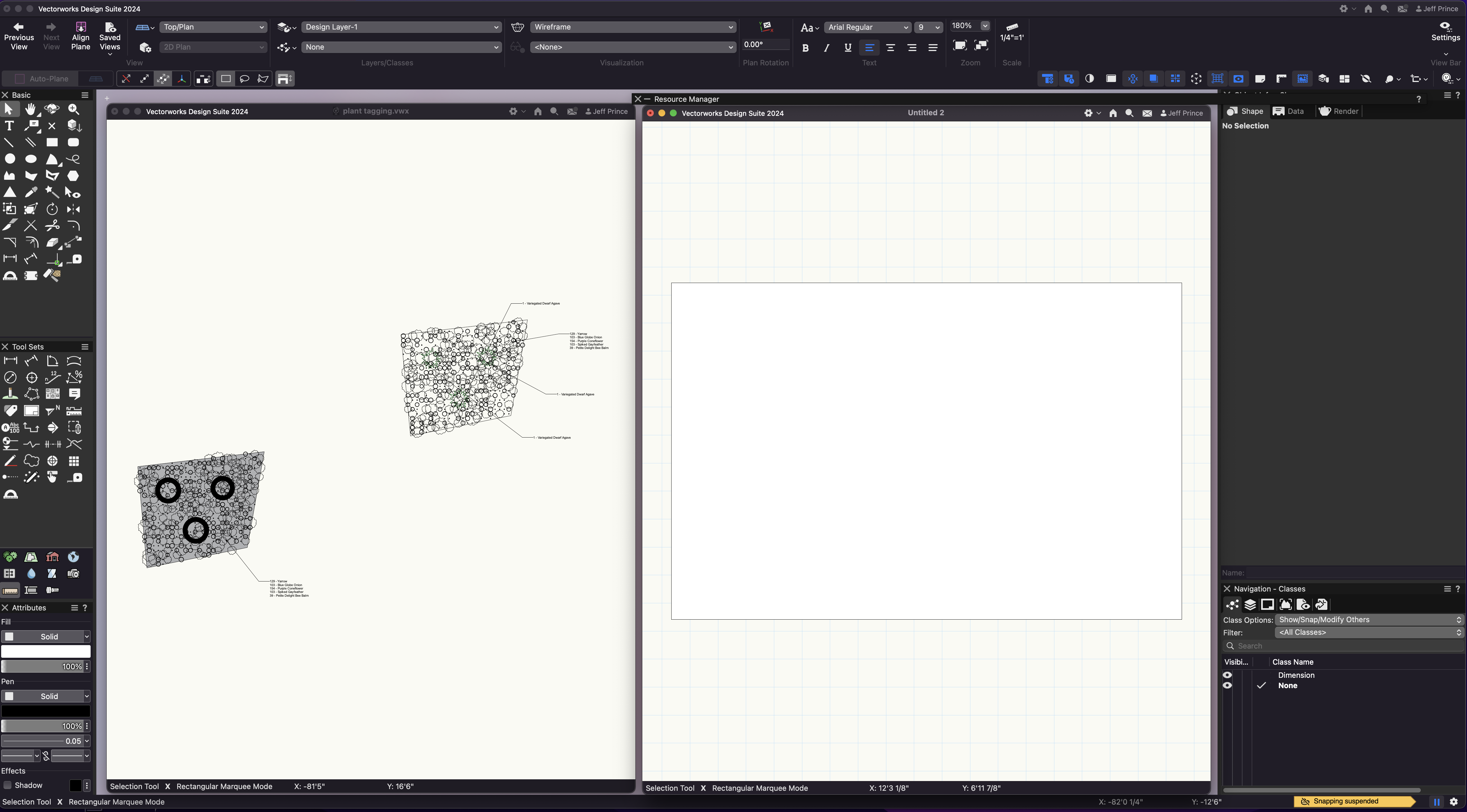

48 minutes ago, Pat Stanford said:
@Jeff Prince But what happens when you click into the drawing on the left?
For me unless I have resized it to only take up 1/2 the screen it comes to the front and hides the right drawing.
I can see times where it would be nice to be able to have a floating non-active drawing window have an always on top option.
the window you clink on becomes active.  On a single monitor, you just arrange them like other windows, leave a bit visible so you have something to click on if you don’t do a 50/50 split. @Rolan Castaneda is right about it being useful on multiple monitors.
Moving a free floating window the an iPad Pro using sidecar might be a nice way to use the functionality if you don't have real dual monitors.

3 hours ago, Jeff Prince said:
So it doesn't work in Windows?
Here's what it looks like in Mac....
Doesn't work for me in Windows.
I can have multiple tabs but I can't peel them off and have 2 side-by-side.
Unless I am doing something dumb (which is very likely)
