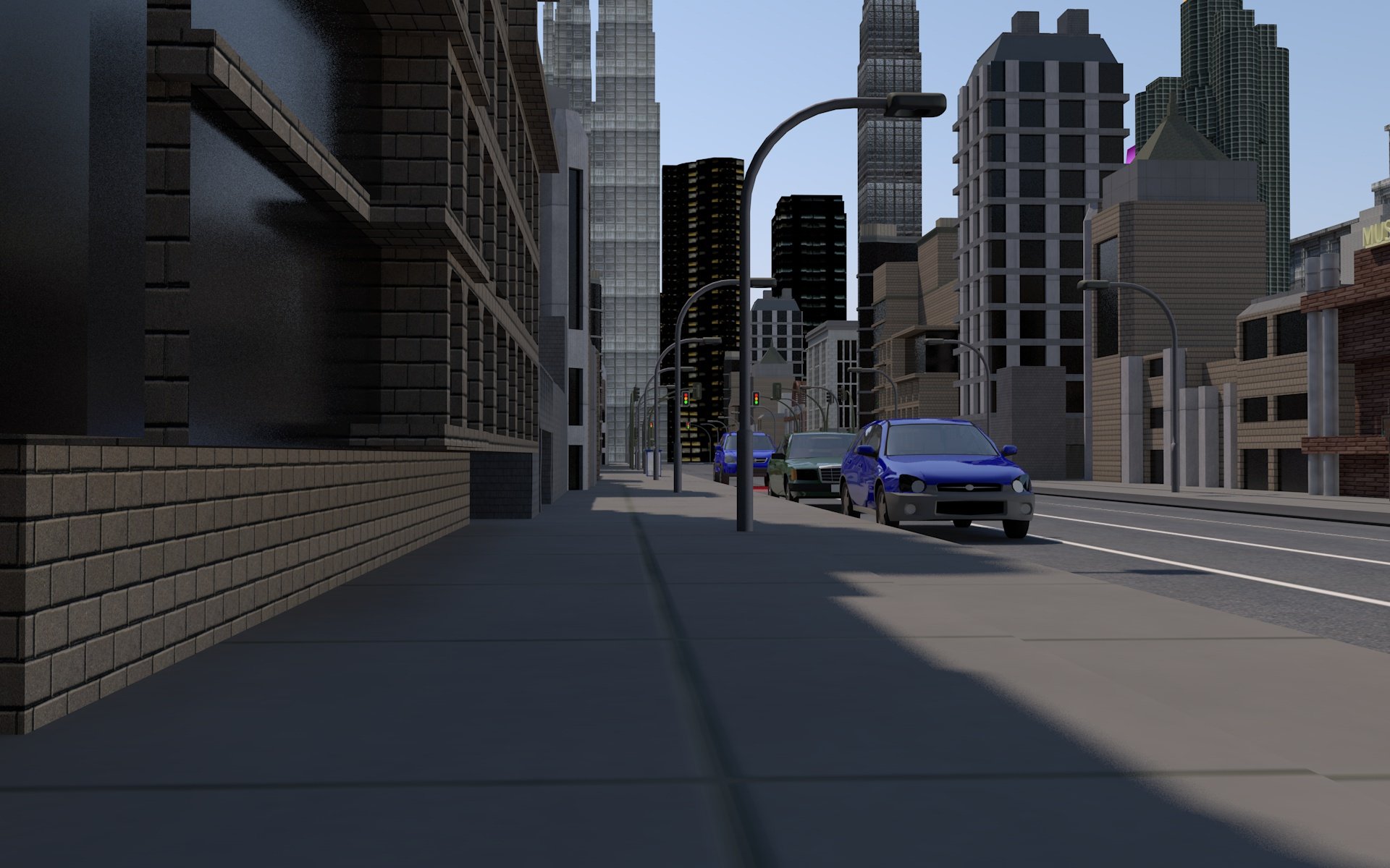

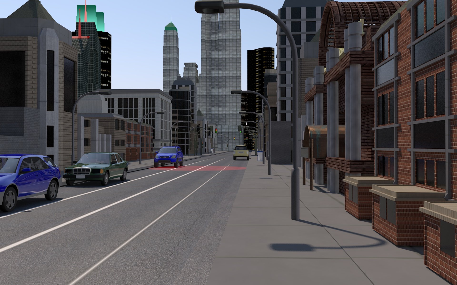

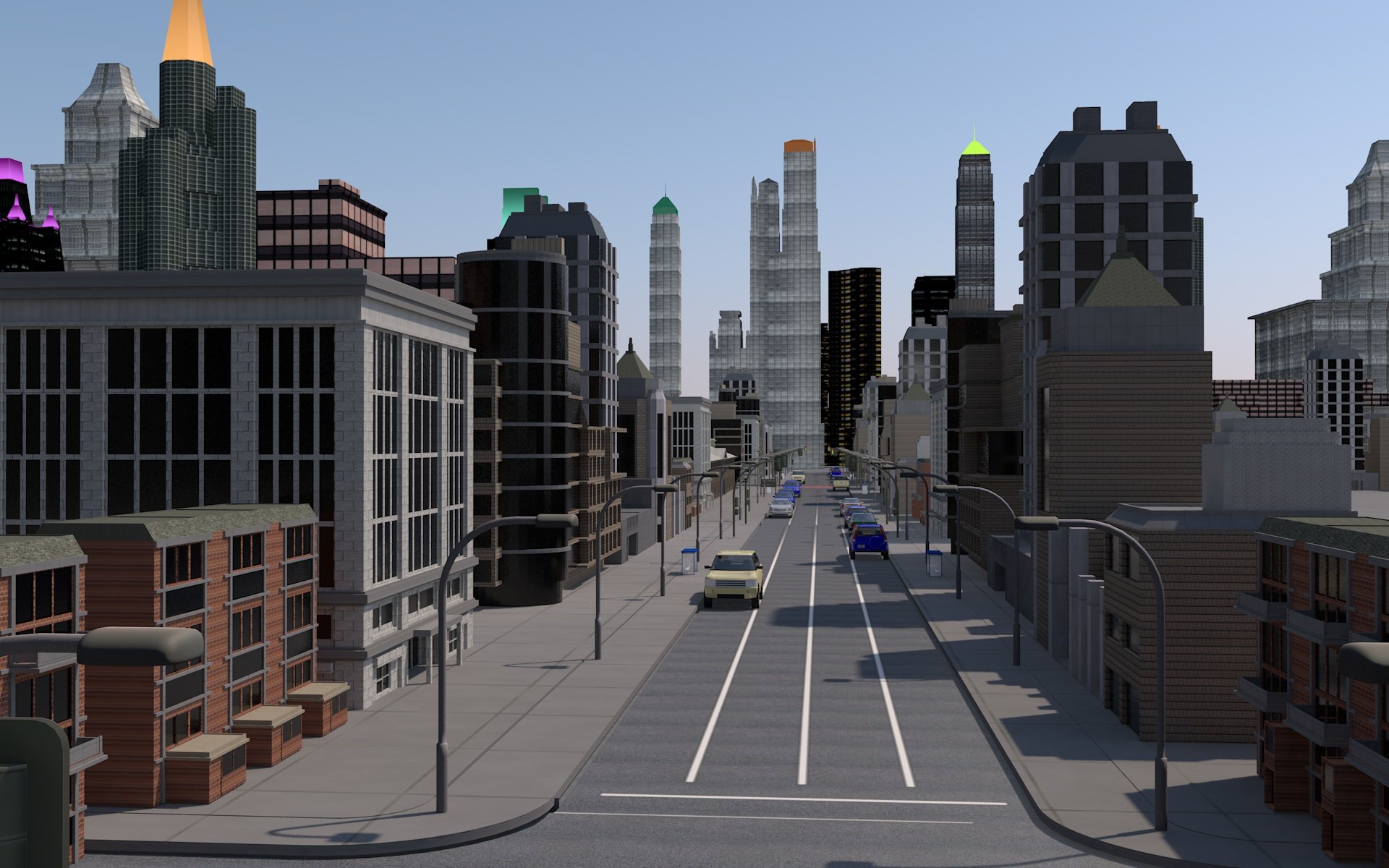

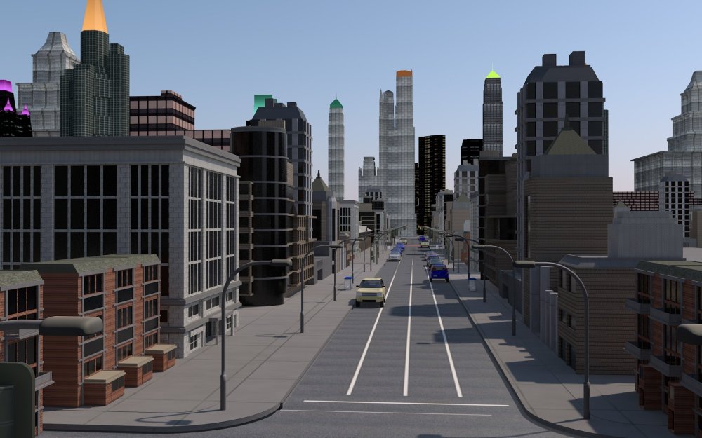

VIRTUALENVIRONS Posted May 27, 2024 Share Posted May 27, 2024 I also use C4D and VW's and have used it in both directions, but it is as @Kevin K described, needs massaging depending on what you are trying to accomplish. Keep in mind that no matter what format you choose to export from C4D, they will come in as blocks of individual polygons. Some formats will group them, others not, so again depends on what you are doing. Normally you can use add solids to connect the polygons and speed things up. The C4D to VW's will work fine if you are the one doing the exporting and importing, as you can import selectively several times and get excellent results. The project below started in C4D, exported to VW's and then back to C4D. 1-The images below started in Cinema 4D. The buildings were part of the C4D library, all solid white, could only be textured in C4D. 2-They were exported to VW's in .dxf format and broken down in Vectorworks. Then reconstructed with add solids in separate parts. 3-They were sent back to C4D to be rendered and animated. 1 Quote Link to comment
