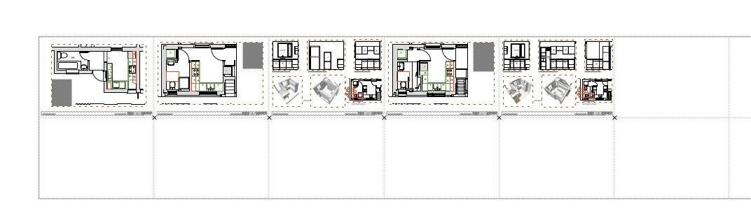

line-weight Posted June 3, 2024 Share Posted June 3, 2024 On 5/25/2024 at 2:42 PM, High_Viz said: typically these reports tend to be about ten A4 pages long… how do you set yours up? One drawing sheet per page - or multiple pages per drawing sheet? For the main drawing set it's one drawing sheet per sheet layer. But there are other things that I sometimes set up as a multi-page document on one sheet layer and it looks something like this Reasons I do this, are to make the document easier to lay out without having to flip between sheet layers, and it keeps my overall sheet layer list from becoming too unwieldy. When I want to produce a PDF I'll do "export pdf" and tell it to export pages 1 to n (in the above example, I'd say 1 to 5) - rather than using the Publish command (which I do use for the main drawing set). Typically I'll do this for things like stuff I send to clients (presenting design options for example) or sometimes things like D&A statements. For D&A statements, if they are lengthy I will often opt to use a proper layout application rather than doing it within vectorworks, mainly because Vectorworks is not good at dealing with large amounts of text content (doesn't allow you to flow it from page to page, and so on). 3 Quote Link to comment

High_Viz Posted June 5, 2024 Author Share Posted June 5, 2024 On 6/3/2024 at 2:23 PM, line-weight said: For the main drawing set it's one drawing sheet per sheet layer. But there are other things that I sometimes set up as a multi-page document on one sheet layer and it looks something like this Reasons I do this, are to make the document easier to lay out without having to flip between sheet layers, and it keeps my overall sheet layer list from becoming too unwieldy. When I want to produce a PDF I'll do "export pdf" and tell it to export pages 1 to n (in the above example, I'd say 1 to 5) - rather than using the Publish command (which I do use for the main drawing set). Typically I'll do this for things like stuff I send to clients (presenting design options for example) or sometimes things like D&A statements. For D&A statements, if they are lengthy I will often opt to use a proper layout application rather than doing it within vectorworks, mainly because Vectorworks is not good at dealing with large amounts of text content (doesn't allow you to flow it from page to page, and so on). This is a good example of the type of drawing booklet im trying to produce, I’ve realised in some title blocks you can have say drawing 302, page 1, page 2 etc so I’m going to experiment with that for making detail books of typical construction details within a file template, I’d done this in 2016 in Revit, and that was just imported autocad detail drawings to make publishing from revit easier so they were not linked details to the model, the details were just 2d lines and fills linked back to a detail ‘marker’ symbol that was put onto sections and plans etc just to show typical locations of the standard details… im just automating all the pain in the ass stuff so projects are quicker and so I can spend my time doing more of the stuff I enjoy doing, like designing, not setting up ‘ bespoke’ reports like D and A in each project from first principles. thanks for your help all… I feel like I’m getting somewhere now Quote Link to comment

_James Posted June 6, 2024 Share Posted June 6, 2024 On 6/3/2024 at 2:23 PM, line-weight said: But there are other things that I sometimes set up as a multi-page document on one sheet layer and it looks something like this Out of interest when you set up sheets like this, do you use automatic drawing coordination? If so, how do you give sheets unique names and numbers in your titleblock? I was considering using this to have some bathroom elevations and plans on one sheet number so that the internal elevation marker can just show one sheet number as it doesn't seem to be able to handle elevations across two sheets. Quote Link to comment
line-weight Posted June 6, 2024 Share Posted June 6, 2024 1 hour ago, _James said: Out of interest when you set up sheets like this, do you use automatic drawing coordination? If so, how do you give sheets unique names and numbers in your titleblock? I was considering using this to have some bathroom elevations and plans on one sheet number so that the internal elevation marker can just show one sheet number as it doesn't seem to be able to handle elevations across two sheets. I use Automatic Drawing Coordination for my main drawings (which are all one page per sheet layer). I don't make use of it for these sheets where I have multiple pages, because they are usually less formal and don't tend to have drawing/section numbers and so on. I just looked to see if the (simplified) title blocks I use on these sheets have ADC turned on and they do ... but I am not sure what would happen if I tried to make use of it! The title Block Manager is aware of the existence of these title blocks and it lists them like this (under the little arrows) I've never really explored how this works as far as ADC is concerned. Presumably ADC would need to know which viewports belong to which TBBs - that's straightforward when there's one TBB per sheet layer but if that's not the case ... can it understand that a viewport is "inside" a TBB? The "Publish" dialogue doesn't list the TBBs like that though - it just lists by the name of the sheet layer. So for example the publish command wouldn't let me publish just pages 1,2 and 3 on the "initial ideas" sheet layer. Quote Link to comment
