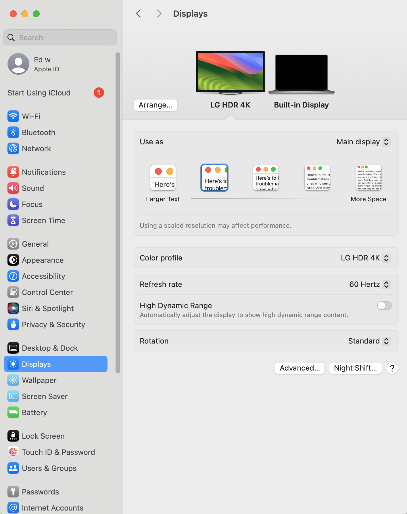

Ed Wachter Posted March 12 Share Posted March 12 On 6/17/2024 at 6:17 AM, Pat Stanford said: I am also running Update 5 and Sonoma 14.5 and I am not having any issues at all. I feel your pain, but I have not other suggestions to make. I recommend you contact Technical Support directly and see if they can help you figure this out. From some other posts it seems like something to do with external monitors, specifically 4K monitors. I'm just now moving to Mac OS 14 (Sonoma). I was completely unable to work in any version of VW until I noticed Pat's comment about 4K monitors. Everything seems to work normally when I unplug my 4K external monitor. Do I have to get a new monitor now? Ed Quote Link to comment
Ed Wachter Posted March 13 Share Posted March 13 Changing the monitor scaling /resolution setting (within the Mac OS System Setting) seems to have resolved the problem. However, I changed the setting back and the problem has not returned. Bizarre! The System Settings has a warning: "Using a scaled resolution may affect performance". But I can't tell which is the default setting and which ones would be considered "scaled". I'll see if everything still works tomorrow morning. Ed Quote Link to comment

zoomer Posted March 13 Share Posted March 13 10 hours ago, Ed Wachter said: "Using a scaled resolution may affect performance" No clue if your M1 would be still affected like some weaker Intel Macs, but yes it can. Especially with 4k Monitors and usual uneven scaling needed. As for a scaling from 4k to something like 3k, macOS will scale the image to double resolution (6k !) and back to 3K. Together with a Retina Macbook Display, that can be too much for some weaker devices. 1 Quote Link to comment
Ed Wachter Posted March 13 Share Posted March 13 With the build-in Retina display the System Settings show you which resolution / scaling is the default; presumably the others would be "scaled". But the System Settings do not show me if there is a default scaling for my external monitor that might be easier on the graphics processing. If anyone knows more about this, please let me know. Just in case it matters, my monitor is an 27-inch LG 4k model. I don't see any drivers that can be updated. Thanks all! Ed Quote Link to comment

Ed Wachter Posted 10 hours ago Share Posted 10 hours ago Thanks for the comments. I've been mostly offline for the last week as I struggled to recover from the disastrous "upgrade" from Monterey to Sonoma. I was completely unable to use any version of VW in Sonoma (with the external monitor). Apple Support says it's not possible to go backwards to a previous OS. Fortunately, our Mac consultant was willing to visit the office with a thumb drive that contained Monterey. So I am up and running again in Monterey again. VW2023, 24 & 25 are all working normally. @E|FA I assume you're on the latest OS. Our consultant advised that we upgrade only as far as Sonoma. We're using M1 chip Macs from December 2021. If I ever need a new monitor, I'll look for that BenQ model. @zoomer thanks for explanation of scaling / resolution. I did not see the button for "default" scaling, so I don't think I tried that during my time in Sonoma. But looking at it now, I think that default is a deal breaker since it scales the image larger than I want. I am happy to be getting back to my old job. It's way more fun than troubleshooting OS conflicts. We will stay on on Monterey until we need new computers. Thanks, Ed 2 Quote Link to comment
