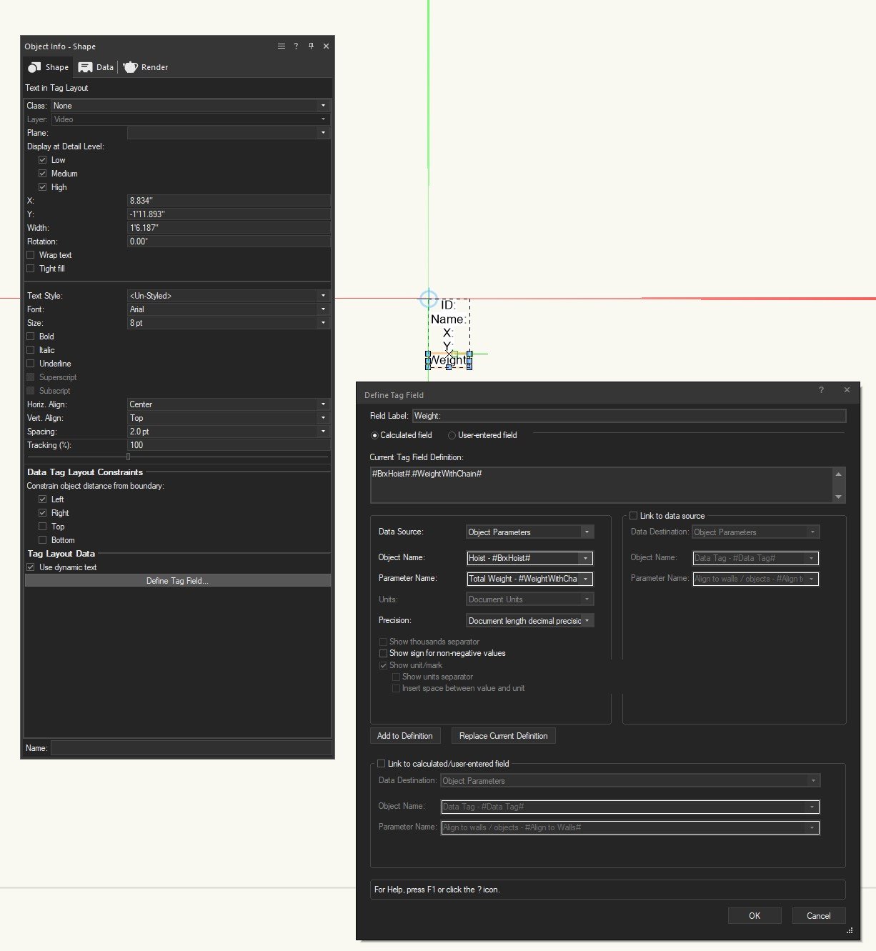

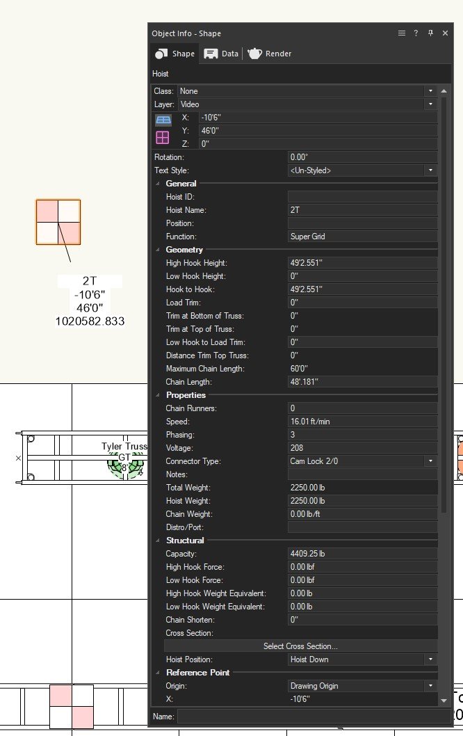

PeanutRigs Posted May 14, 2024 Share Posted May 14, 2024 I'm having issues with these data tags not displaying weights correctly. I've followed the tutorial video on creating data tags and everything else works fine, but I have no idea what VWX is using for the weight number. I have tried doing the user specified field as well, but it's giving me the same thing. This was not a problem with the old hoist tool, I'm still not sure why this was changed. I can't actually tell the hoist what its total weight is, which I think is part of the problem here. (I don't let VWX do my weights, since things as simple as hoist self weights are wrong.) Anyone have any ideas besides just going back through my drawing and dropping in Legacy Hoists? Quote Link to comment

Mike Rock Posted May 15, 2024 Share Posted May 15, 2024 Try using Total Weight (formatted) for the tag On 5/14/2024 at 2:56 PM, PeanutRigs said: Anyone have any ideas besides just going back through my drawing and dropping in Legacy Hoists? Quote Link to comment
