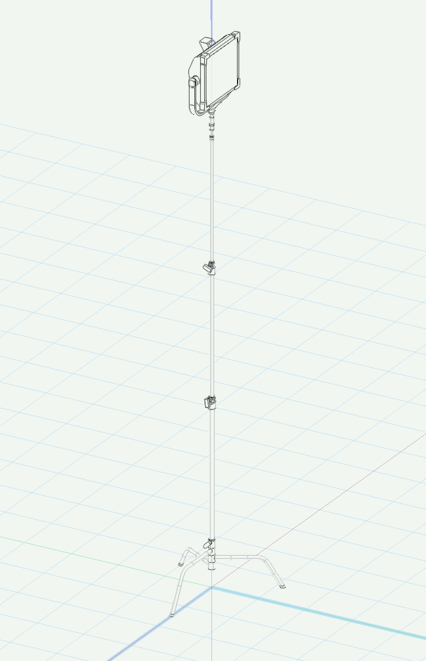

Martin Benesh Posted May 13, 2024 Share Posted May 13, 2024 Hi All, I'm really excited about the 3D snapping implications of accessories. However, I have a suite of accessories like snapgrids, chimeras, etc. that I need a 2D component below the 2D symbol of the parent fixture. Is there a way I can resolve this issue? Thanks, Martin Quote Link to comment
Vectorworks, Inc Employee Scott C. Parker Posted May 14, 2024 Vectorworks, Inc Employee Share Posted May 14, 2024 @Martin Benesh Can you post an example file with a couple of fixtures and accessories to play with? A quick sketch of what you're looking to do would be helpful as well. Quote Link to comment

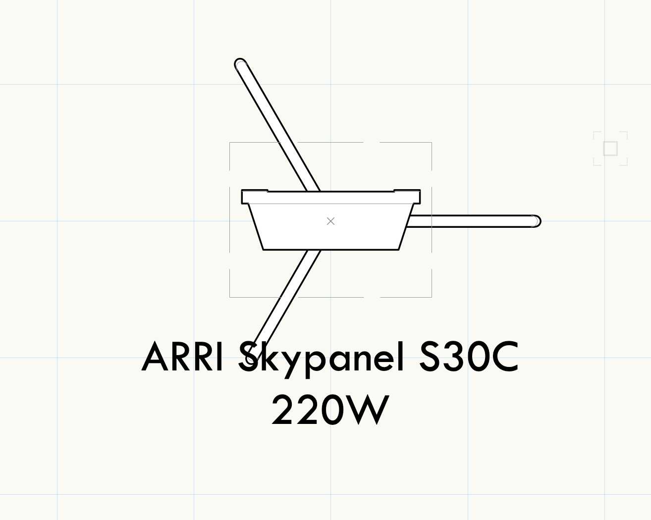

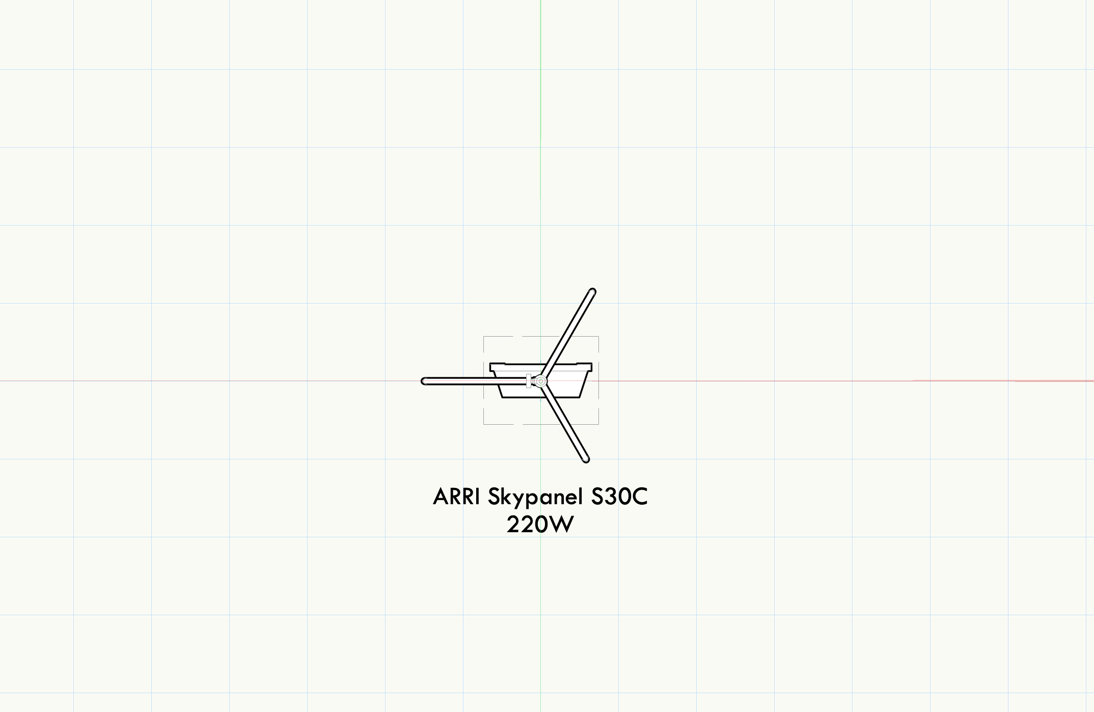

Martin Benesh Posted May 15, 2024 Author Share Posted May 15, 2024 Hi @Scott C. Parker, Attached here is a Vectorworks file and some screenshots detailing the problem! I can't get the accessory's 2D components to default insert underneath the symbol like in the "ideal photo". (Which I made from just dragging 2D geometry around.) What appeals to me is the 3D functionality of accessories; automatically snapping things in place and aligning them! If you have any other questions, don't hesitate to reach out! I appreciate all the help! Thanks, Accessory Sample for Forum .vwx Quote Link to comment

Vectorworks, Inc Employee Scott C. Parker Posted May 17, 2024 Vectorworks, Inc Employee Share Posted May 17, 2024 On 5/14/2024 at 8:20 PM, Martin Benesh said: I can't get the accessory's 2D components to default insert underneath the symbol Hi @Martin Benesh it turns out that 2D geometry of accessories is hard coded to sit on top of the 2D geometry of lighting devices. This video shows a workaround of editing the 2D geometry of the stand so it looks as if it is sitting under the head of the light ng unit. I've also included the file. Accessory Sample for Forum .vwx AccessoryUnderLight.mp4 Quote Link to comment
Martin Benesh Posted May 21, 2024 Author Share Posted May 21, 2024 Hi Scott, Understood! Thanks for getting back to me! Might you have some recommendations; perhaps I could make a marionette command that could do something like what I want? Thanks! Quote Link to comment
Vectorworks, Inc Employee Scott C. Parker Posted May 22, 2024 Vectorworks, Inc Employee Share Posted May 22, 2024 22 hours ago, Martin Benesh said: Might you have some recommendations Since the accessories are coded to land on top of lighting symbols, the only suggestion I have right now is to duplicate them and make your own versions, cutting out the 2D parts. We'll give it some thought, but it would be a while before anything happens since editing the symbols is a valid alternative. Quote Link to comment

Martin Benesh Posted May 24, 2024 Author Share Posted May 24, 2024 Hi, Scott! John Salutz recommended copying the lighting fixture's 2D geometry to a dummy accessory. That way one could reorder them in the Object Info Palette. I think it's a helpful recommendation, but I'll probably just move forward with two different symbols: one an accessory with the 3D geometry, and a second with just 2D geometry that I can place behind the fixture. Best, Martin 2 Quote Link to comment
