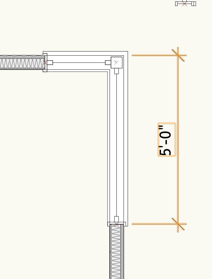

Certain corner windows on my project don not appear correctly in plan view. I have tried replacing them with duplicates of the windows that do appear corectly and they exhibit the same behavior. This is a project that was started in VW2023 and migrated over to VW2024. The 3D views seem to be fine. The walls are all joined properly.Screenshot2024-03-21at1_41_27PM.thumb.png.5cc0b708f8b3075866a5905188ea73b3.png

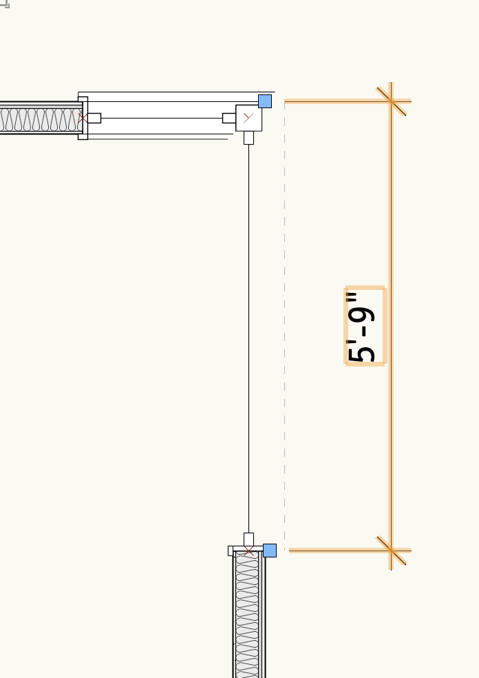

I found the setting in "walls" but did not see a setting for being enabled or not.
I have been trying different thing. I was able to get  5'0" window to work. I started increasing the length by 1" and when it got to 5'9 it reverted back to the weird behavior. I have a couple of custom configuration windows wider than 6' that seem fine.

I think with the changes to Doors/Windows in VW2024 Wall Closures somehow became more central but I don’t really know or understand the details. I have only started using VW2024 in earnest since Update 4 due to various bugs. @Matt Panzer would be the one to explain the under the hood role of Wall Flosures + comment of the problem with the fill.
The issues with corner windows are a known bug.  The reason using wall closures give different results in the sills is because window sills and door threshold automatically fit themselves to the shape of the wall closure.  While this is a big improvement, implementing the door and window handing features in 2024 required major code changes that caused this issue that still needs to be resolved.

A fix was just put in place for the upcoming 2025 release.  It has not been put in a 2024 update because the nature of the change requires more time for testing.
Unfortunately, the only reasonable workaround is to do as you suggest by removing the sill from the window and creating your own.  I realize that's far from ideal.
