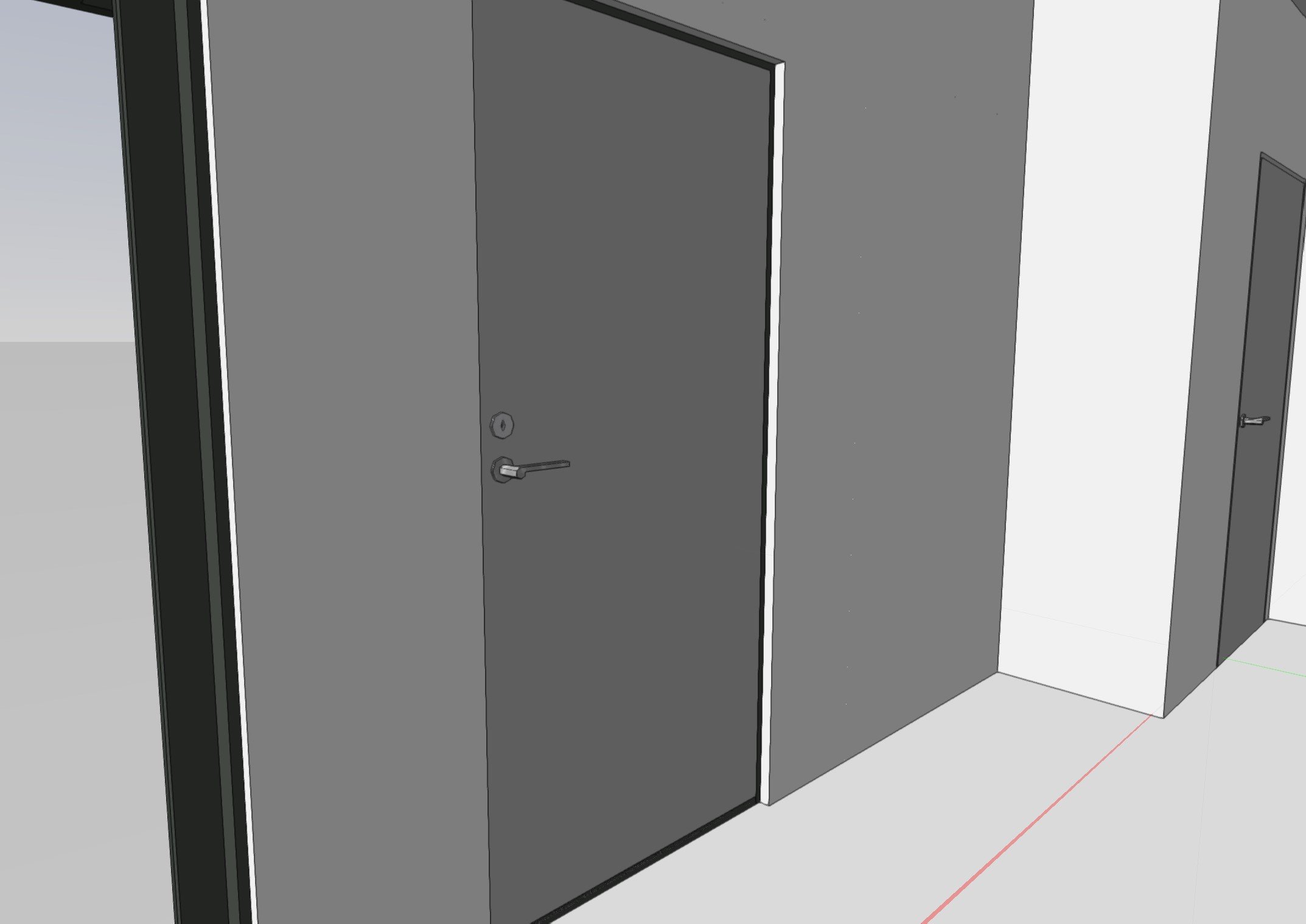

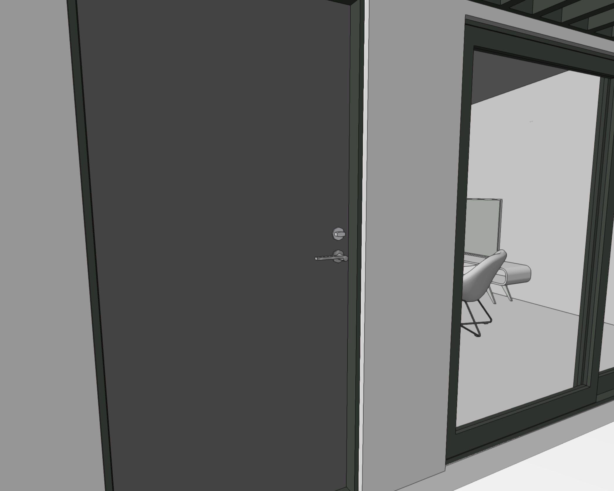

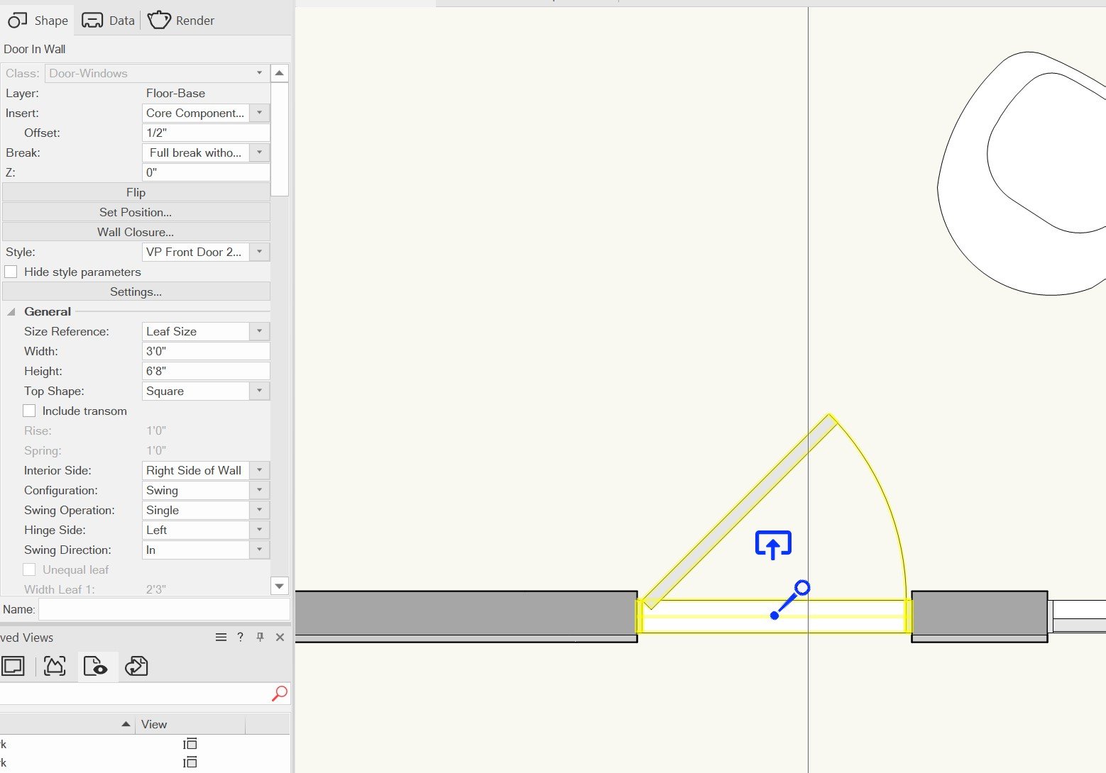

Eric Nickerson Posted March 7, 2024 Share Posted March 7, 2024 Does anyone know why my door hardware is reversed in 3D? The deadbolt keyed entry is on the inside while the thumb lever is on the outside. It seems like my door is oriented correctly in plan. Swing direction is "in" and the blue indicator is showing which direction is inside of my room. This is the case for all of my doors, not just this one. -eric 1 Quote Link to comment

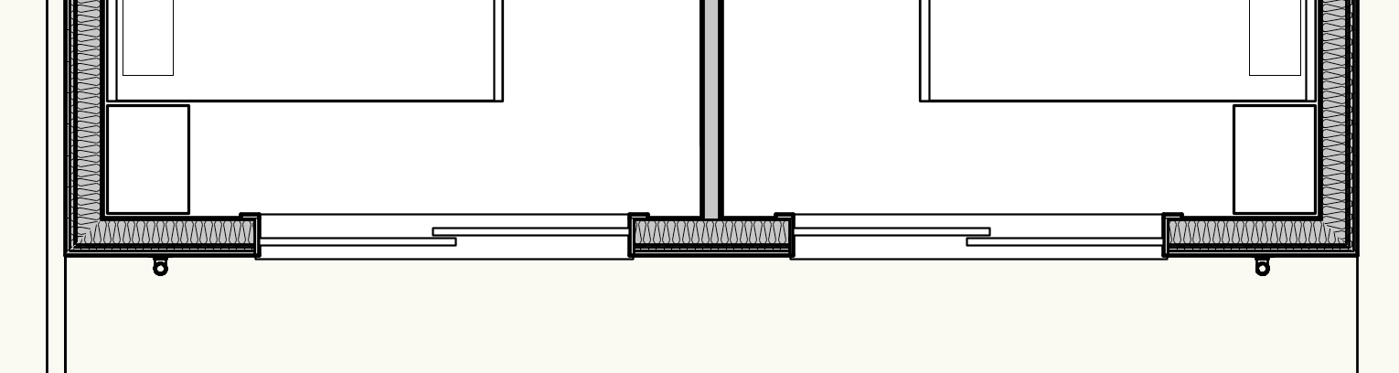

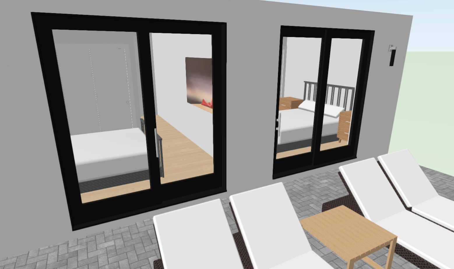

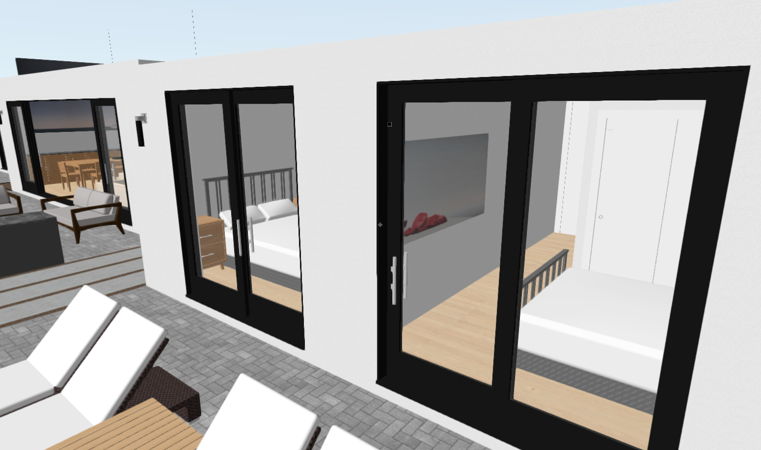

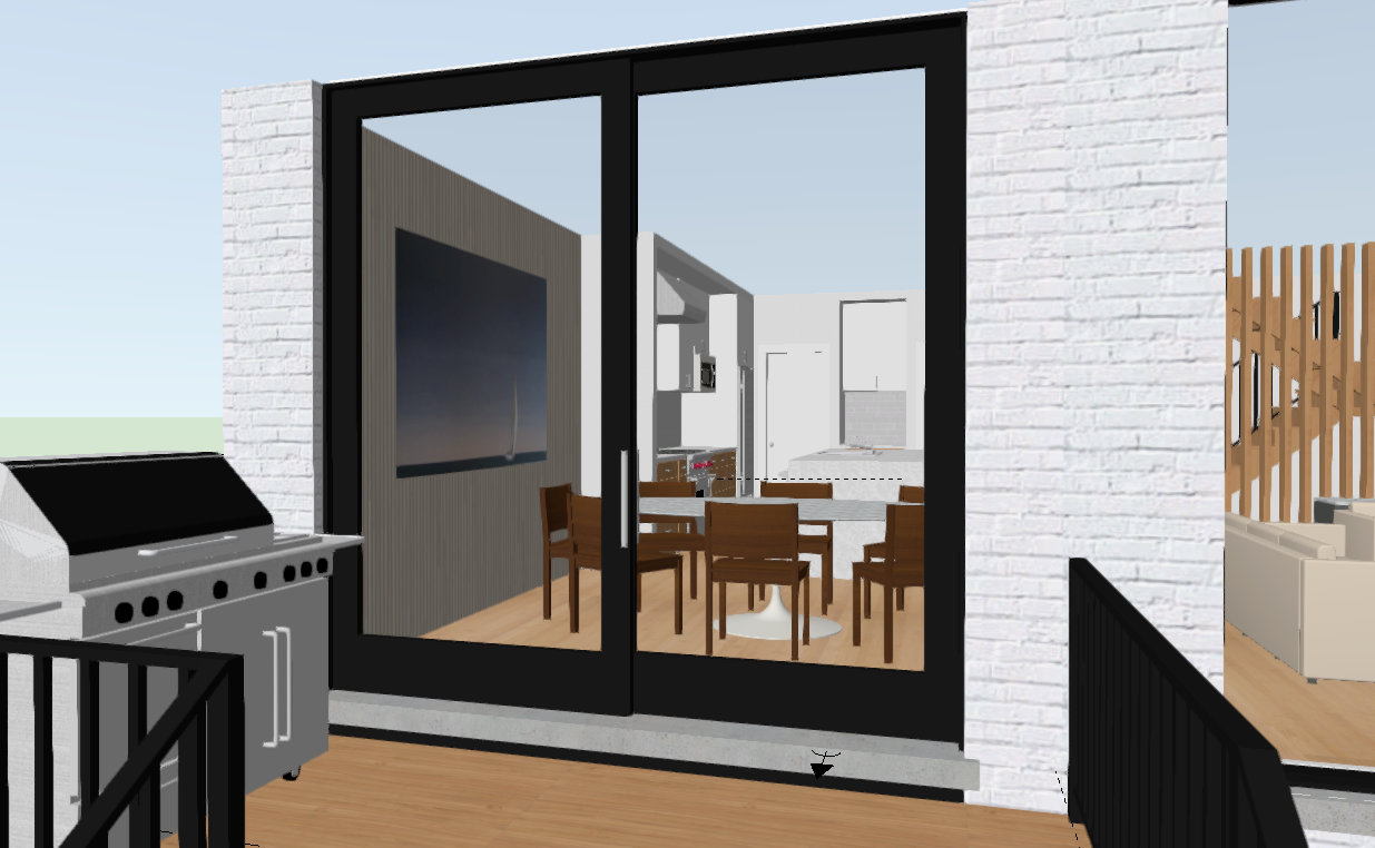

kob Posted May 8, 2024 Share Posted May 8, 2024 I'm having a similar problem with door hardware on sliding doors. In some instances, the hardware is correctly shown on the jamb side at the interior of the operating panel. But, in some cases it is shown on the operating panel where it overlaps the exterior fixed panel. Which is, of course, impossible. Here is a screen shot of two mirror image sliding doors in plan. The door on the left has the operating panel on the right, so the hardware should be next to the right jamb. The door on the right has the operating panel on the left, so the hardware should be next to the left jamb. Here is a shot of the exterior in 3D from one side. And then from the other. The sliding door on the left is clearly wrong. No amount of flipping the door or modifying the settings will get that door handle in the right spot. I'm using Vectorworks 2024 on Sonoma. I've just checked and I'm using the most up to date version. Quote Link to comment
