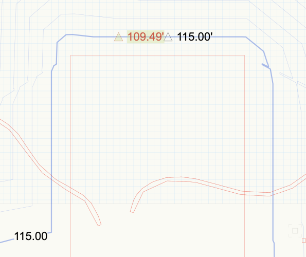

Jeff Prince Posted March 7, 2024 Share Posted March 7, 2024 The stake tool is capable of displaying either the existing or proposed elevation as you noted and regardless of how the site model is set to display (existing vs proposed). Are you sure you have your stake configured correctly? If so, it should work. Example of how stakes should behave. Left one is set to Existing site model, right one is set to Proposed. Blue contour is proposed 115'. Quote Link to comment

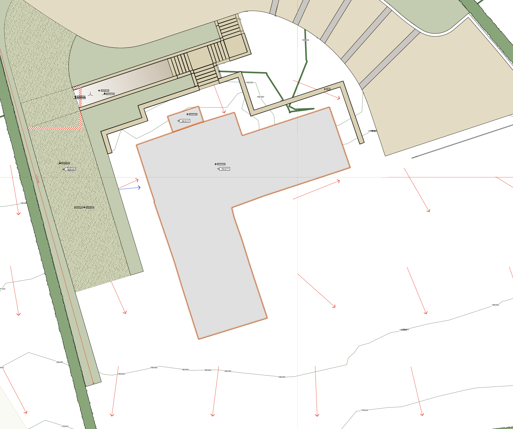

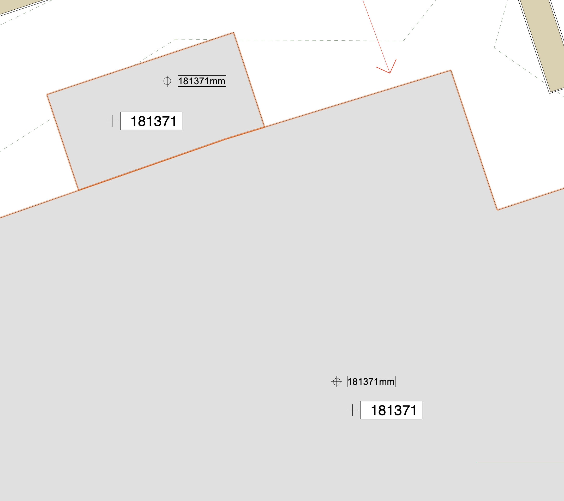

Tom W. Posted July 25, 2024 Share Posted July 25, 2024 Hi Lisa I'm not really sure what's going on in your file to be honest. I am not a landscape expert so perhaps someone else can shed some light on it but basically of all the Hardscapes in the file only the two selected below are 'seen' by the Send to Surface command: So on these two Hardscapes only I can send a Stake or a Data Tag to surface + specify the Hardscape + both will return the elevation of the Hardscape: All of the other Hardscapes fail to send to surface if I choose Hardscape in the 'Choose Hardscape' dialog + just return an elevation of zero. I even double-checked in a test file + Planar Pad, Aligned + sloping Hardscapes there all return the correct elevation when I run Send to Surface. Hopefully someone else will look at your file + identify what's causing the issue... Quote Link to comment
