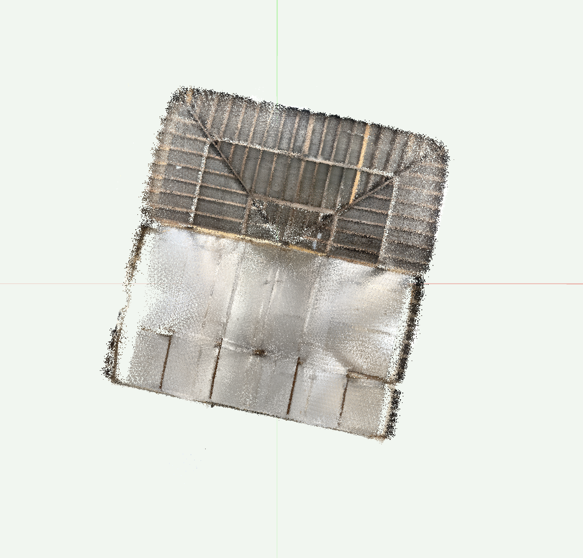

Tom W. Posted February 3, 2024 Share Posted February 3, 2024 7 hours ago, Rishie said: I don’t see much useful information in Vectorworks Can you post a screenshot of what you see? Quote Link to comment

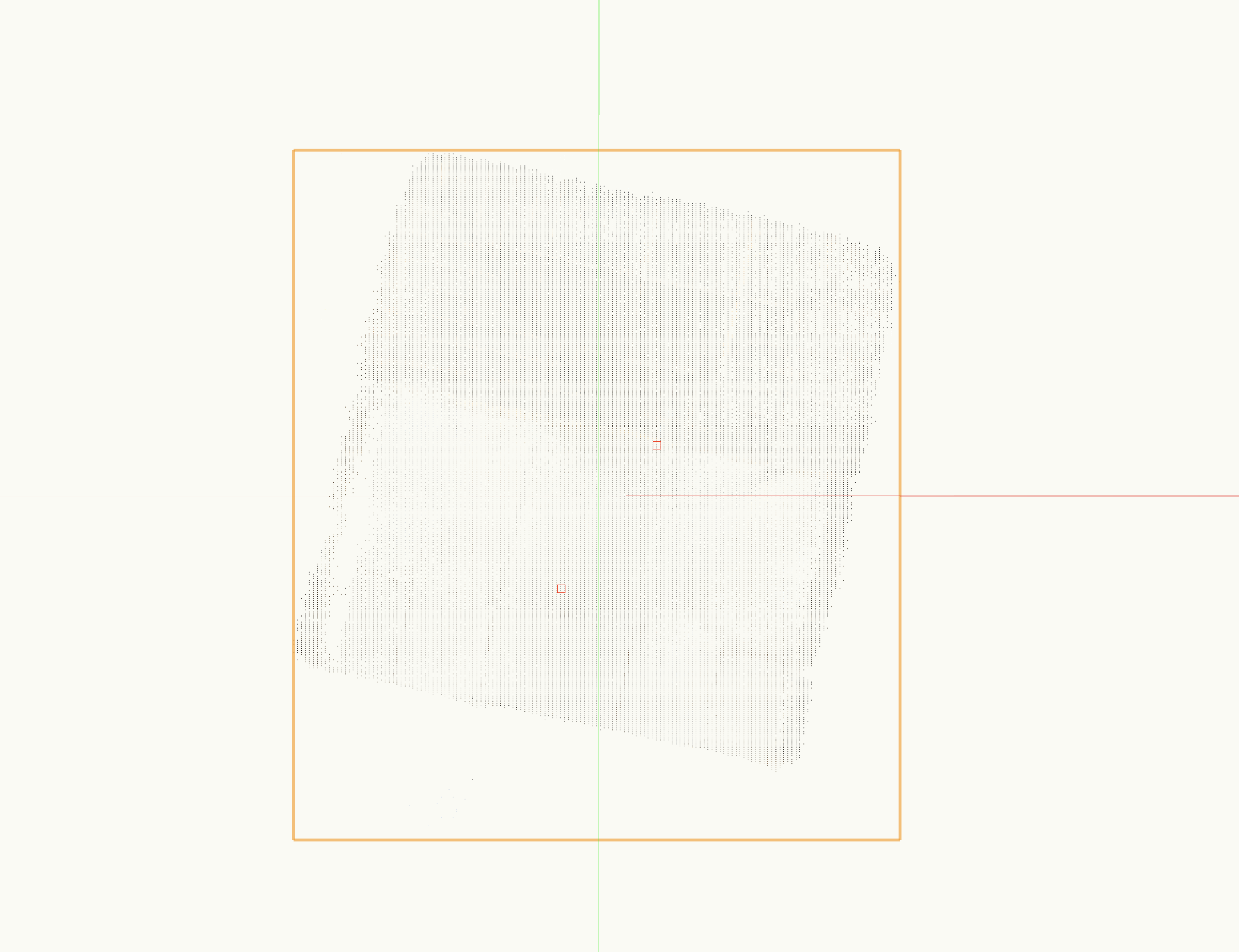

Rishie Posted February 4, 2024 Author Share Posted February 4, 2024 Hi @shorter The number of points on the source file was 361,562,352. However, when I set the import percentage to 100%, the number of imported points was only 100,000,000. This discrepancy might be causing me to lose information. Could you please assist me in configuring Vectorworks to import all 361,562,352 points? Your help would be greatly appreciated. Hi @Tom W. I've recorded a short video showcasing the model in Vectorworks and CloudCompare. Just to let you know, when I open the model in Autodesk Recap, I can find more useful information. There, I can delve into the model, exploring floor plans and interior elevations with much more detail. Thank you for your assistance. Scan to BIM.mp4 1 Quote Link to comment
Tom W. Posted February 4, 2024 Share Posted February 4, 2024 The fact that the Point Cloud is displaying with those vertical bands with gaps in between suggests it was imported into a Georeferenced file. Is this the case? I have posted about this in the past: any time you try + import a point cloud into a georeferenced file half the points will be missing. Very annoying. If your file is georeferenced try running 'Set User Origin to Internal Origin' + reimporting the point cloud with 'Center Import on Internal Origin' enabled + see if the results are any different. You can re-georeference the file again afterwards + manually move the point cloud to the correct geographical location assuming you have a means of locating it. Quote Link to comment
Rishie Posted February 5, 2024 Author Share Posted February 5, 2024 Hey @Tom W. I set the user origin to Internal Origin, and this approach yielded better results. Thank you very much. This approach has been very helpful. However, it's worth noting that the .e57 file contains 361,562,352 (three hundred sixty-one million plus) points, and Vectorworks can only import a maximum of 100,000,000 (one hundred million) points at a time. Consequently, I was only able to import less than one-third of the points. I've requested the scanning company to break the point cloud file into three or more files, with each file containing a maximum of 100,000,000 (one hundred million) points. I believe this would enable me to import them fully into Vectorworks. I just want to check if there is a way to import more than 100,000,000 (one hundred million) points. Thank you very much for your assistance 1 Quote Link to comment
