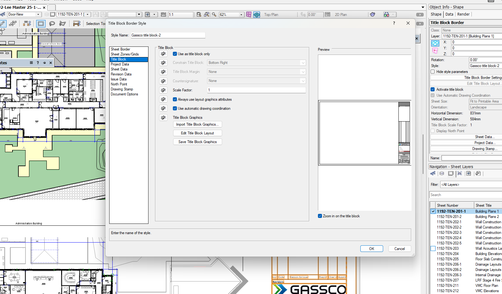

I'm happy to have it set in the style rather than by instance.. in fact I thought it was, see screenshot, but doesn't seem to be reflected on the sheets...

It is by style on the sheets, that's why it's greyed-out:
because it's set in the style + can't be overridden in the instances of the style.
