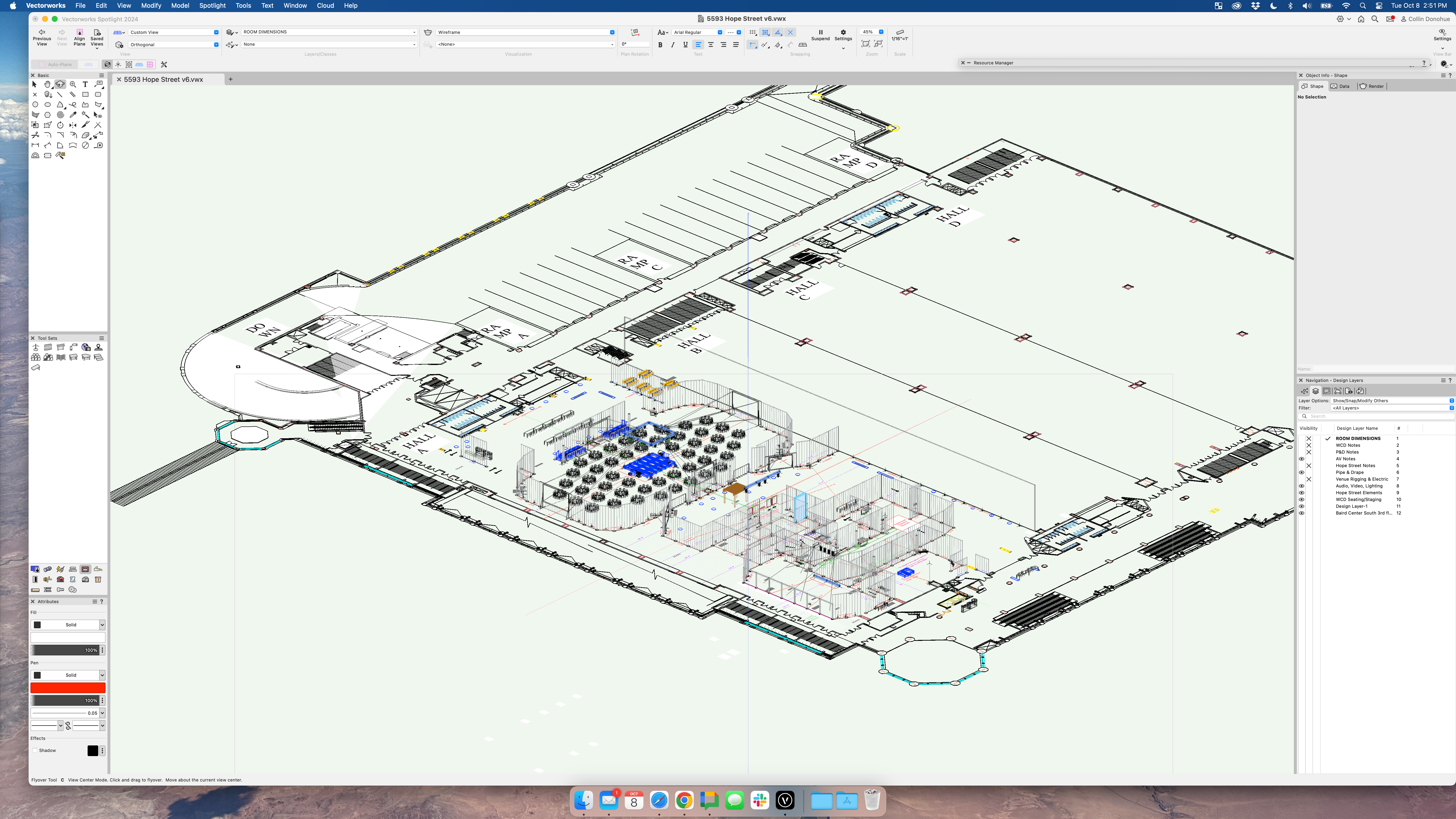

I may have stumbled upon a solid work-around.  The problem seems to occur when I have the window maximized (NOT full-screen, window is resized to fill screen).  However, if I shrink the LEFT side of my Vectorworks window so that it's a small distance away from the left edge of my display, everything displays exactly how it should without any lagging.  I have moved my tool pallets to other places on the screen and it didn't seem to make a difference.  As long as I have that gap between the left edge of the Vectorworks window and the left edge of my screen, all is well!  I have tested this with both 2024 and 2025, and I've tried this with multiple display resolutions.  Attached is a screenshot of the window resizing I did.  If I make the left edge any closer to the monitor, it starts to get laggy again.  Hope this helps a few people at least!

As a follow-up to my own setup, it's not the left side specifically, it's actually happening wherever I have my two displays meeting.  For my setup, I have my laptop set up on the left side and my external on the right, with VW running on the external monitor.  However, if I go into the macOS display arrangement and flip them so that my external is on the left and my laptop on the right, the issue now occurs when the VW window is all the way to the RIGHT side of my display!
