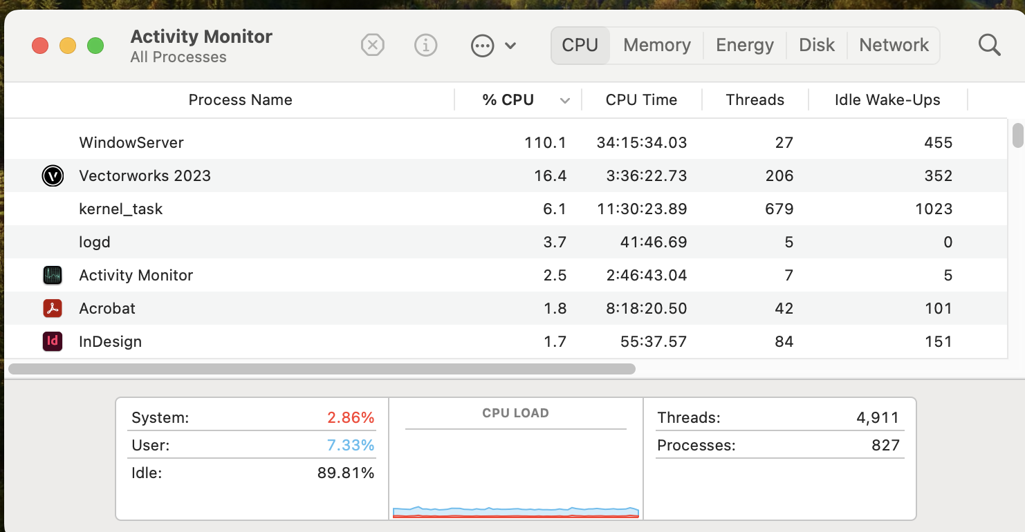

Hi
I have the same problem but I'm still on 2023. I'm on a Macbook Pro Apple M3 Max, 36GB Ram and running Sonoma 14.1. Using a 4k monitor connected with HDMI.
I had the same problem on my old Macbook Pro 2019 which prompted me to upgrade. Immensely frustrating to still be in the same boat. I find that I can control the lag a little better if I make the Vectorworks window smaller on my external monitor instead of full screen. But running it on full screen bogs down the whole computer. I've attached a screenshot of my activity monitor with vectorworks acting up during scrolling and zooming then then a second screenshot with vectorworks on fullscreen on my external monitor but using chrome (to write this post), vectorworks in the background. You can see the windowserver is still hogging all the CPU. This is repeatable.
I hope there is an answer!
Regards,
Helena
  • Like 2
