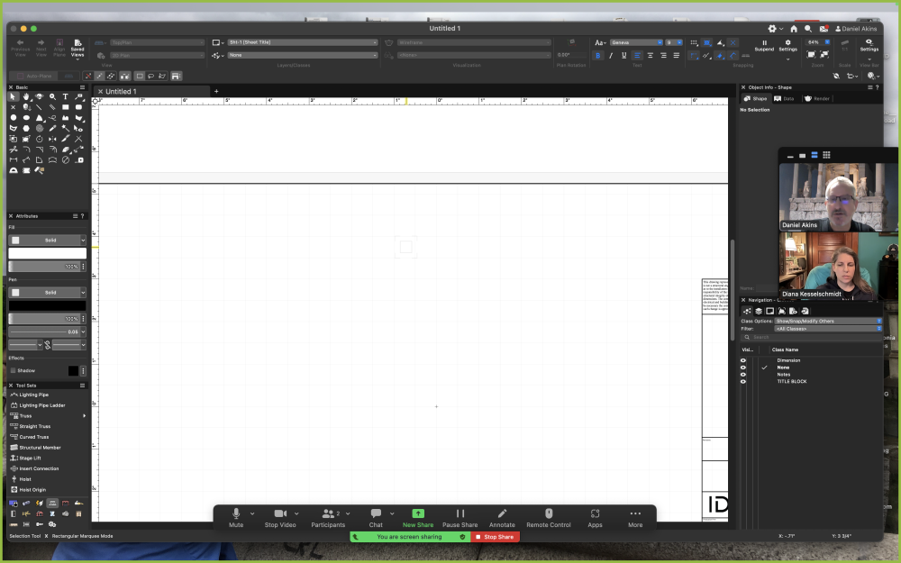

Dan Akins Posted January 12, 2024 Share Posted January 12, 2024 I am having similar issues with VWX menus not being visible on start up of the program. My workaround has been to have some type of external monitor connected to my computer before starting VWX24 for the first time in the day. The VWX menus are not visible across the top of my screen when I start up VWX for the first time after a full startup of my MACBook Pro from being OFF. This has been a consistent problem since first installing VWX24 in DEC with update 1. I am running Mac OS Sonoma 14.2.1, but the issue was happening with earlier versions of SONOMA as well. I attached two screen shots to show the missing drop-down menus before I add an external monitor and then after the monitor is added, the menus return and work fine. Further, if I remove/disconnect the external monitor, the VWX24 menus stay fully functional. Also, once I get the VWX menus working, if I close out of the VWX program and then open the program back up again, the menus continue to work fine. It seems to be only the first start up of the VWX program after a new startup of my Mac machine that the menus disappear. I am running MacOS 14.2.1 on a 16-inch, 2019 MacBook Pro with Intel UHD graphics 630 (1536MB) and VWX 2024 update 2.1 Quote Link to comment
Dan Akins Posted January 12, 2024 Share Posted January 12, 2024 adding to my post above-- My work around is to carry an iPad and always connect the iPad to my computer as an added monitor, then start up VWX. Quote Link to comment
