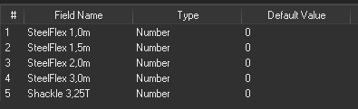

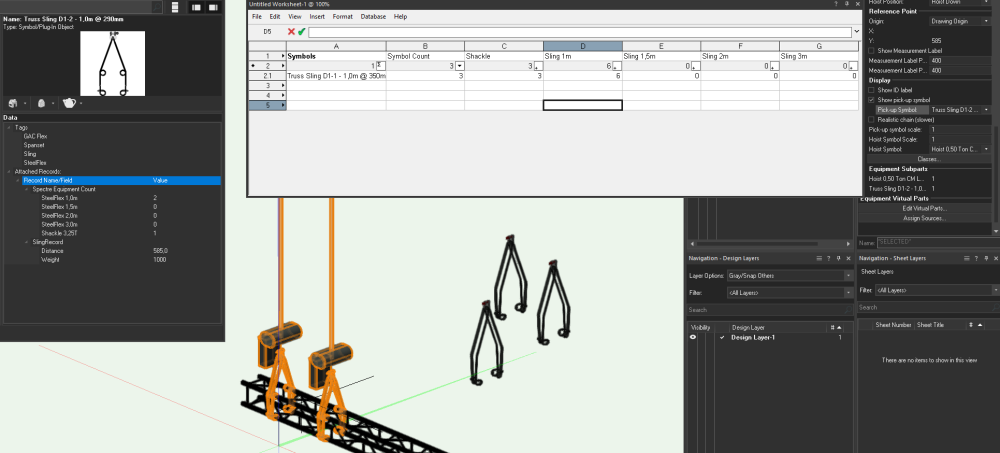

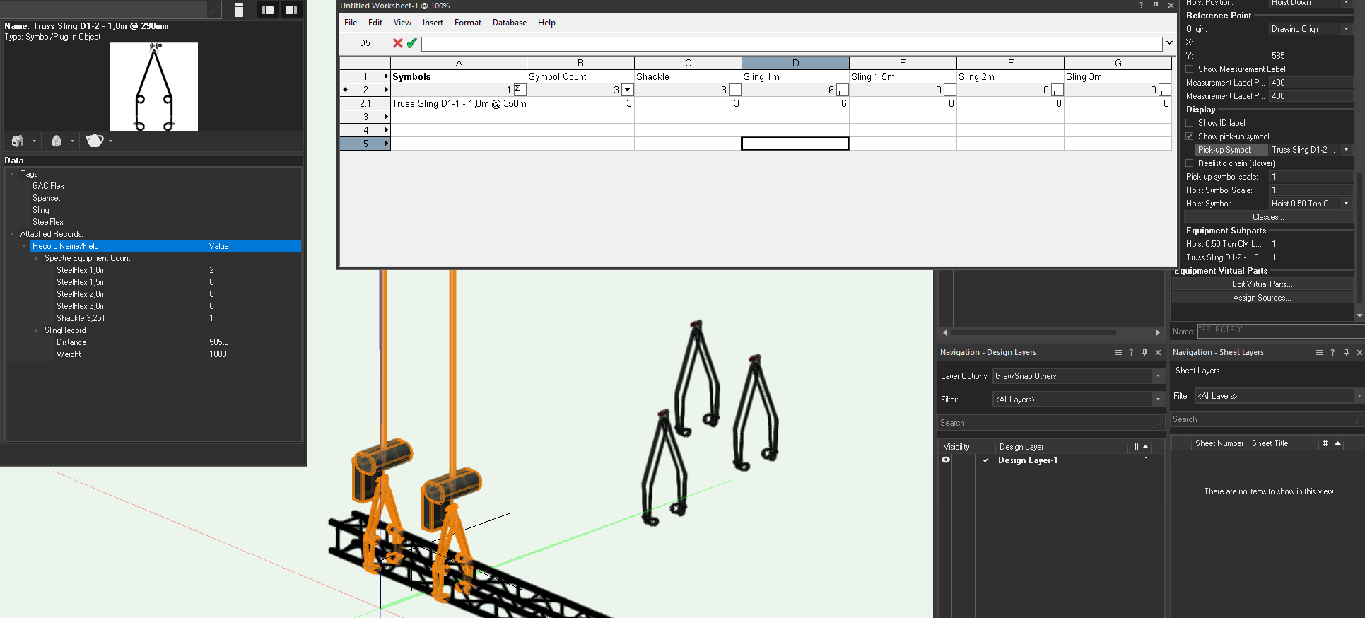

Stefan B. Posted November 3, 2023 Share Posted November 3, 2023 Hey, I started creating my own hoist pickup symbol, and they look good enough to represent correct heights and they are found via the Object Info. When starting the project of creating the correct slings and height that we use, I figured I could attach an additional record to provide information on sling length and quantity. So I created a record with fields as number type. If I draw the symbols in my drawing directly, I'm able to count and summarize the correct quantity of shackles and steelfexes in the drawing, but if I use the Hoist Object info and select the Truss sling symbol, the worksheet cannot "find" it. Is it possible to fetch the record of the Truss pick-up symbol? Quote Link to comment
Vectorworks, Inc Employee jcogdell Posted November 3, 2023 Vectorworks, Inc Employee Share Posted November 3, 2023 In the report criteria have you toggled on the subparts option? Quote Link to comment
Stefan B. Posted November 3, 2023 Author Share Posted November 3, 2023 hey, yes, I have tried all the options. 🙂 Subparts, with and without parent Symbol, plug-in object on and of. Quote Link to comment
