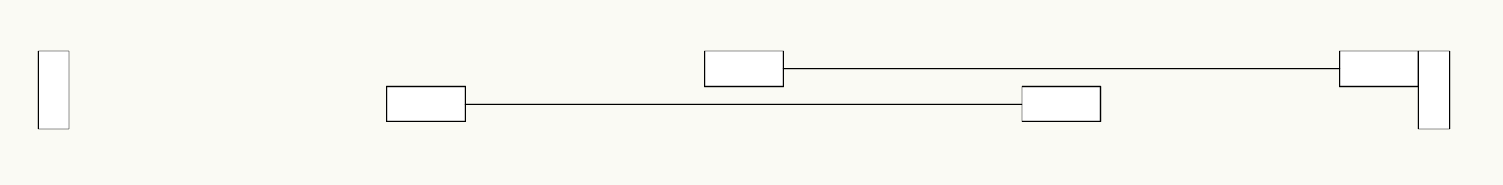

I am having an issue with the display of my sliding door with a glass leaf in Top/Plan view. The leaf is showing as solid but I would like it to display the side rails (sash) and the glazing same as window objects. Is that even possible? Am I missing a setting? Any help would be much appreciated.

if you configure the sliding door so it uses classes for the graphic display of the components....
You can set the "leaf" and "jamb" to match a class for your windows or set them to a class that matches the windows graphics, I would go with the latter personally.
The middle door is using this method while the others are using default door characteristics.
  • 0
I think @Kevins330 wants to see the stiles + glazing in section the same way you do with Windows. The Door Tool doesn't facilitate this but WinDoor does if you wanted to try that:
