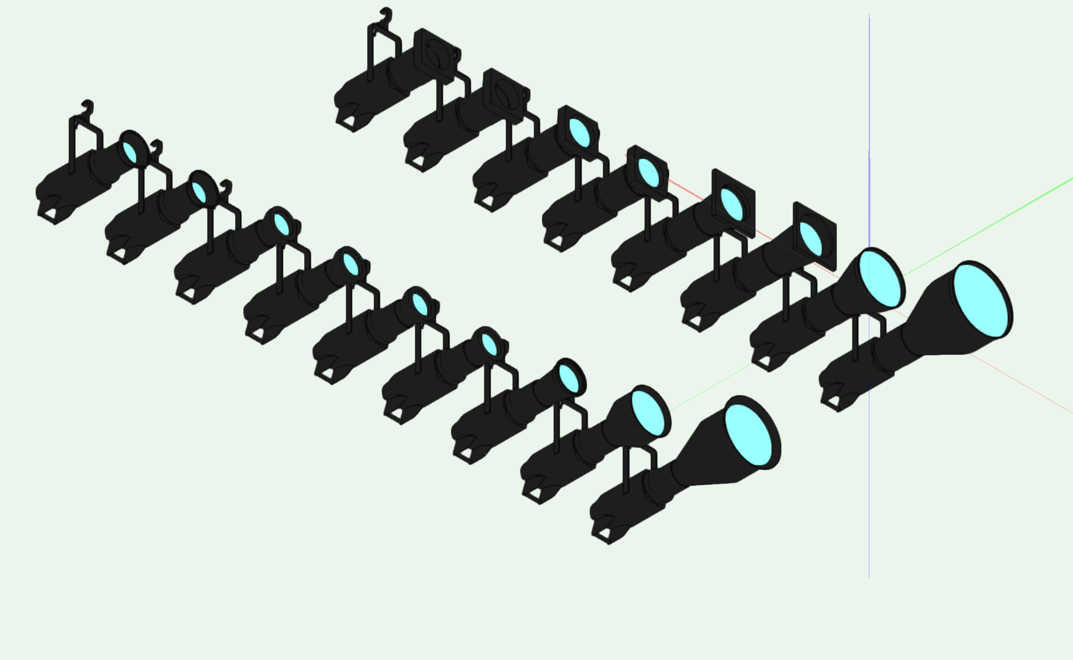

Jesse Cogswell Posted September 13, 2023 Share Posted September 13, 2023 (edited) I had a couple of projects where I used Lustr Series 3 fixtures and needed accurate geometry, so I built my own off of the CAD files provided by ETC. A file containing them is attached (in VW2022 format, but I can backsave as necessary), it contains symbols for both the XDLT shutter barrels as well as the standard Source 4 / Source 4 EDLT shutter barrels. The EDLT tubes use the geometry from the standard VW library, but the XDLT tubes were all modeled from the ETC CAD files. ETC LED Series 3 Symbols.JNC v2022.vwx Edited September 13, 2023 by Jesse Cogswell 2 2 Quote Link to comment

Jesse Cogswell Posted September 13, 2023 Share Posted September 13, 2023 A user pointed out that the EDLT fixtures in my demo file would turn into "zombie objects" if you did any manipulations of them. This was because I removed the dreaded "Lighting Instr" prefix from the symbols but didn't update the Lighting Device objects to compensate. The symbols would still work properly if imported into another file or if new fixtures were placed through the Resource Manager. In any case, a corrected file is attached below. No changes to the underlying symbols have been made. ETC LED Series 3 Symbols.JNC v2022.vwx 3 Quote Link to comment

Vectorworks, Inc Employee JustinVanHassel Posted September 13, 2023 Vectorworks, Inc Employee Share Posted September 13, 2023 Thank you for providing this file Jesse as i know that it will help a lot of users. I just want to give an update that we are currently correcting the VW version of the file and while we are in there we have decided to make the Daylight and Lustr X8 versions with the matching photometrics and libraries for all available EDLT, XDLT, Standard and Zoom tubes in each body symbol. These symbols will have the updated Device Body and Device Lens fields populated in the OIP as well as the new Universal Equipment Record to work with the new Equipment Lists and Summary Key features in VW2024. Also going to confirm that the weights of the fixtures are correct and include the body, barrel, and lens tube as I have heard that there are some ETC libraries that may have this incorrect. This update will take in the September 2023 update to the Premium Libraries in the English International version of VW2024. 2 1 Quote Link to comment
