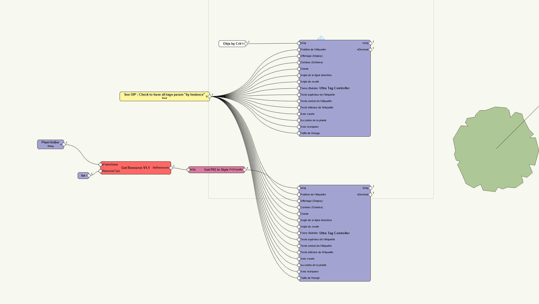

Nico_be Posted Monday at 11:24 AM Author Share Posted Monday at 11:24 AM (edited) Hi, I was tired of having to run the MassEditPlantStyle script for each label field, so after some research, I created a small marionette node that allows you to change all the parameters of the plant labels in the file by setting them “by style” or “by instance.” The other node below allows you to configure each field “by style” or “by instance” separately, which affects all the plants in the file. It's in French, and if I have some time, I'll translate it into English. It'll be easier and faster that way! If you prefer a script: import vs # --- VARIABLES GLOBALES --- g_choix_tag = '16383' g_plant_folder = '' kID_TextInfo = 10 kID_CheckStyle = 11 kID_CheckInstance = 12 kID_FolderName = 13 kID_FolderMenu = 14 styles_modifies = [] # --- RÉCUPÉRATION DES DOSSIERS DE SYMBOLES --- def get_plant_folders(): folders = [] listID, numItems = vs.BuildResourceList(16, 0, '') for i in range(1, numItems + 1): objH = vs.GetResourceFromList(listID, i) if objH: parentH = vs.GetParent(objH) if parentH: typeN = vs.GetTypeN(parentH) name = vs.GetName(parentH) if typeN == 92 and name and name not in folders: folders.append(name) return sorted(folders) # --- DIALOG --- def CreateMyDialog(): dialog = vs.CreateLayout("Configuration des Tags de Plante", True, "Appliquer", "Annuler") vs.CreateStaticText(dialog, kID_TextInfo, "Les modifications seront appliquées aux plans placés sur le layer actif", 60) vs.CreateCheckBox(dialog, kID_CheckStyle, "Passer en mode : By STYLE") vs.CreateCheckBox(dialog, kID_CheckInstance, "Passer en mode : By INSTANCE") vs.CreateStaticText(dialog, kID_FolderName, "Dossier ressources plantes :", 40) vs.CreatePullDownMenu(dialog, kID_FolderMenu, 40) # ← ID séparé pour le menu vs.SetFirstLayoutItem(dialog, kID_TextInfo) vs.SetBelowItem(dialog, kID_TextInfo, kID_CheckStyle, 0, 0) vs.SetBelowItem(dialog, kID_CheckStyle, kID_CheckInstance, 0, 0) vs.SetBelowItem(dialog, kID_CheckInstance, kID_FolderName, 0, 4) vs.SetRightItem(dialog, kID_FolderName, kID_FolderMenu, 0, 0) return dialog def make_handler(dialog, folders): def DialogHandler(item, data): global g_choix_tag, g_plant_folder if item == -1 or item == 12255: # SetupDialogC — les deux valeurs selon la version vs.SetBooleanItem(dialog, kID_CheckInstance, True) g_choix_tag = '16383' for folderName in folders: vs.AddChoice(dialog, kID_FolderMenu, folderName, 0) if folders: vs.SelectChoice(dialog, kID_FolderMenu, 0, True) elif item == kID_CheckStyle: vs.SetBooleanItem(dialog, kID_CheckInstance, False) vs.SetBooleanItem(dialog, kID_CheckStyle, True) g_choix_tag = '0' elif item == kID_CheckInstance: vs.SetBooleanItem(dialog, kID_CheckStyle, False) vs.SetBooleanItem(dialog, kID_CheckInstance, True) g_choix_tag = '16383' elif item == 1: # Bouton Appliquer selectedIndex = vs.GetSelectedChoiceIndex(dialog, kID_FolderMenu, 0) if selectedIndex >= 0: g_plant_folder = folders[selectedIndex] return DialogHandler # --- LOGIQUE RESSOURCES --- def get_resources_in_folder(folderName, resourceType=16): objList = [] hFolder = vs.GetObject(folderName) if hFolder is None: return objList listResourcesID, numItems = vs.BuildResourceList(resourceType, 0, '') for cnt in range(1, numItems + 1): objH = vs.GetResourceFromList(listResourcesID, cnt) if objH is not None: parentH = vs.GetParent(objH) if parentH == hFolder: tempStr = vs.GetNameFromResourceList(listResourcesID, cnt) objList.append((tempStr, objH)) return objList # --- LOGIQUE STYLE --- def modifier_pio_in_style(hSymDef): hChild = vs.FInGroup(hSymDef) while hChild: if vs.GetTypeN(hChild) == 86: vs.SetRField(hChild, 'Plant', '__Tag_value_flags', g_choix_tag) vs.ResetObject(hChild) break hChild = vs.NextObj(hChild) vs.ResetObject(hSymDef) def modifier_styles_depuis_ressources(folderName): resources = get_resources_in_folder(folderName, resourceType=16) for styleName, hSymDef in resources: if styleName not in styles_modifies: modifier_pio_in_style(hSymDef) styles_modifies.append(styleName) # --- LOGIQUE INSTANCES --- def modifier_instance(h): if vs.GetTypeN(h) == 86: vs.SetRField(h, 'Plant', '__Tag_value_flags', g_choix_tag) vs.ResetObject(h) # --- EXECUTION --- dialog = CreateMyDialog() folders = get_plant_folders() if vs.RunLayoutDialog(dialog, make_handler(dialog, folders)) == 1: styles_modifies = [] if g_plant_folder: modifier_styles_depuis_ressources(g_plant_folder) vs.ForEachObject(modifier_instance, "(T=86)") vs.ReDrawAll() mode_str = "by STYLE" if g_choix_tag == '0' else "by INSTANCE" vs.AlrtDialog(f"Succès : Toutes les étiquettes de plantes sont maintenant en mode {mode_str}") Plants tags by Style or by Instance V1_1.vwx Edited Tuesday at 10:00 AM by Nico_be The style was not modified in the resources, but now everything works. 3 Quote Link to comment
Vectorworks, Inc Employee Katarina Ollikainen Posted Monday at 01:56 PM Vectorworks, Inc Employee Share Posted Monday at 01:56 PM @Nico_be, that is a nice script. I'm sure that went much faster than having to go through one setting at a time. If you don't have access to it, I would suggest opening the file with the plants you want to change and then start the Plant Style Manager. You can batch edit anything that is allowed with the identical setting there, and this includes the by style/by instance settings (You can't batch edit things like plant ID and style name, as they must be unique in the file). 1 Quote Link to comment
Nico_be Posted Monday at 02:07 PM Author Share Posted Monday at 02:07 PM 10 minutes ago, Katarina Ollikainen said: @Nico_be, that is a nice script. I'm sure that went much faster than having to go through one setting at a time. If you don't have access to it, I would suggest opening the file with the plants you want to change and then start the Plant Style Manager. You can batch edit anything that is allowed with the identical setting there, and this includes the by style/by instance settings (You can't batch edit things like plant ID and style name, as they must be unique in the file). @Katarina Ollikainen Yes, but I have to modify column by column (field by field), and during my last attempt, VW crashed. It was on a file with 2,000 plants. Here, with this script, it's much smoother and faster. 1 Quote Link to comment
Nico_be Posted Monday at 03:48 PM Author Share Posted Monday at 03:48 PM (edited) Unfortunately, I just realized that although the change is visible in the OIP, it is not reflected in the plant style; the settings remain unchanged when editing the plant... If anyone has any ideas, I'm interested!🤪 EDIT:See original message, everything is OK now. Edited Tuesday at 07:46 AM by Nico_be Quote Link to comment
