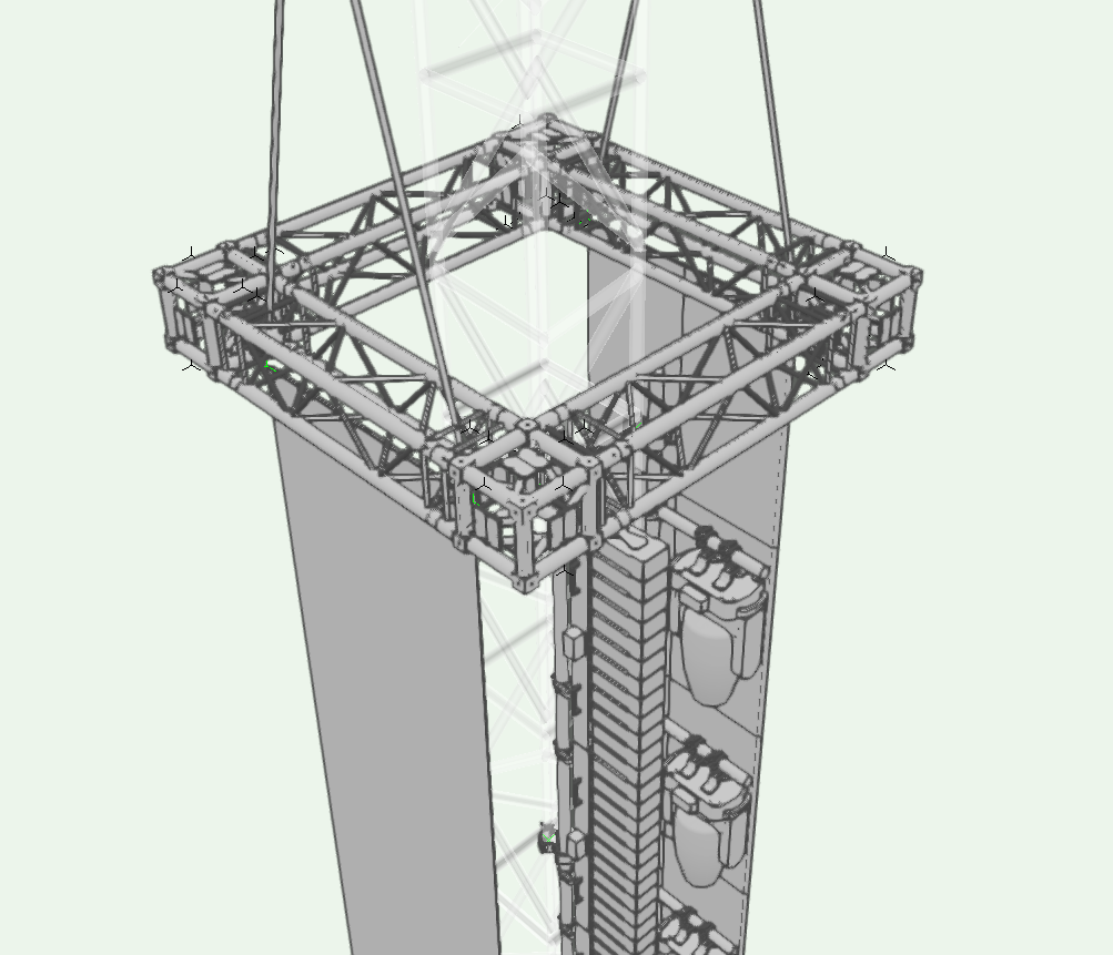

Mike Wright Posted yesterday at 08:48 AM Share Posted yesterday at 08:48 AM Is there a resolution to this? I have a lighting design where I need to repeat the below multiple times but no matter how I try to achieve this, the lights all snap to the square of truss above when I paste/paste as a group/create symbol and repeat etc. Quote Link to comment
Vectorworks, Inc Employee Scott C. Parker Posted yesterday at 11:53 AM Vectorworks, Inc Employee Share Posted yesterday at 11:53 AM 3 hours ago, Mike Wright said: the lights all snap to the square of truss above Are you talking about the lights that look like they should stay snapped to the pipes below the truss? Can you share a copy of this for use to play with? Quote Link to comment
Mike Wright Posted 22 hours ago Share Posted 22 hours ago I am indeed. The pipes are not 'pipes' in the VW sense though, they are a symbol made up of solids so the lights are not currently snapped to anything. The work around I have used it to CTRL+drag the rigging and LED with the LX layer turned off and then duplicate just the LX and ALT+drag them into position. You cannot add the ALT modifier to CTRL+drag Tent pin.vwx Quote Link to comment
Vectorworks, Inc Employee jcogdell Posted 21 hours ago Vectorworks, Inc Employee Share Posted 21 hours ago @Mike Wright Move by points should work pretty well for this in 3D Quote Link to comment
