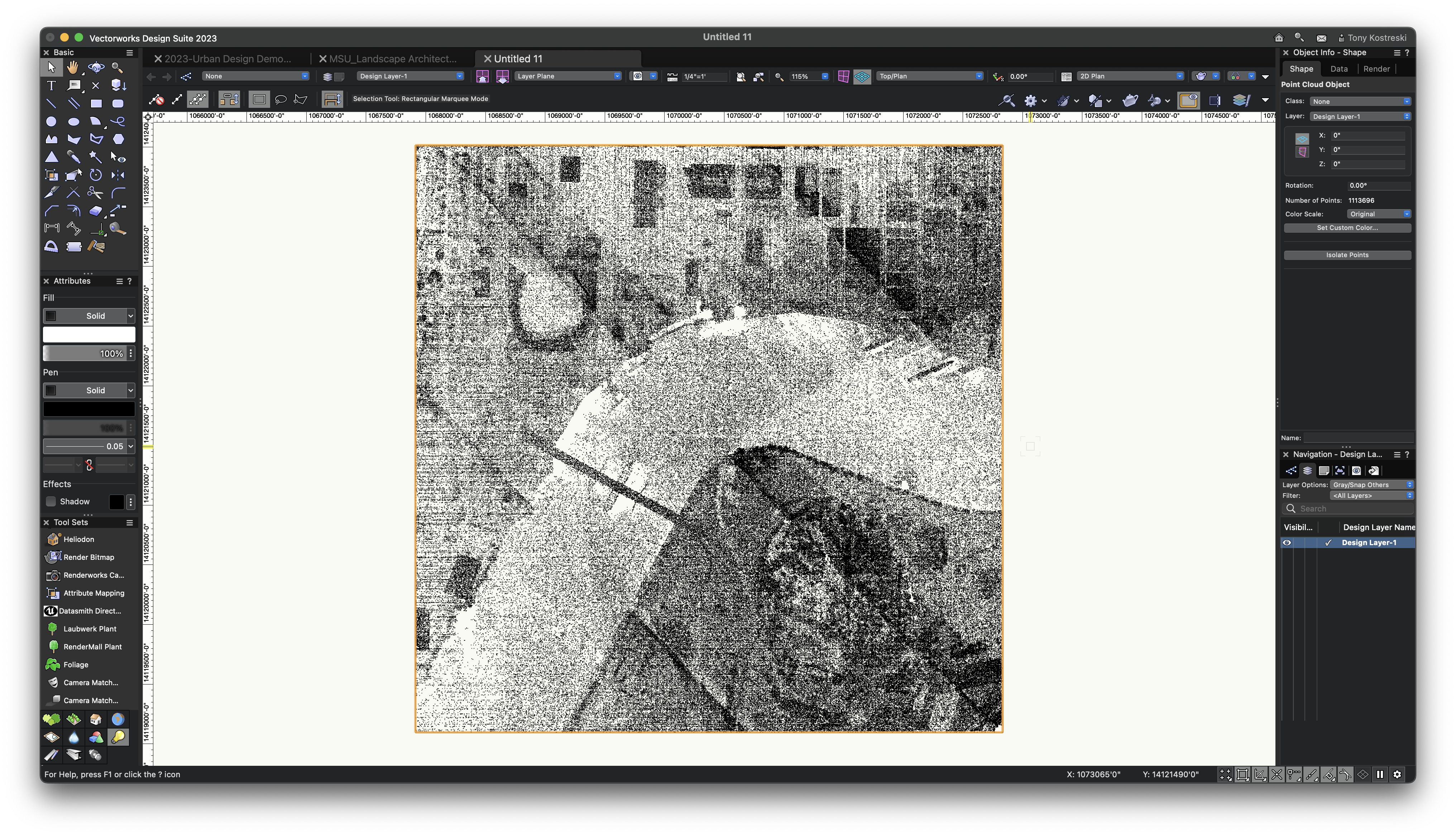

Administrator JuanP Posted March 1, 2023 Administrator Share Posted March 1, 2023 @jeff prince @Tony Kostreski one of our Landscape architects helped me downloading a .laz file from that page and and importing it in Vectorworks 2023 - see the results. Could you try the file attached and see if you have the same issues. USGS_LPC_MD_VA_Sandy_NCR_2014_18SUJ325303_LAS_2015.laz 1 Quote Link to comment
