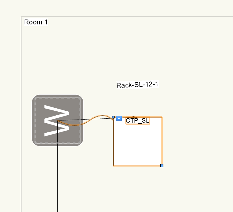

wscooper Posted February 16 Author Share Posted February 16 So, as a workaround I tried connecting a speaker with a generic type, and gave it a CTP name. I haven't found any drawbacks yet, I'll post back if I find one. Seems a good indication that being able to tag the drop point might be a good workflow. Thinking about it, being able to tag a ceiling drop point with a speaker ID would speed up things as well where a speaker object isn't specifically needed. Best of both worlds? Quote Link to comment
wscooper Posted February 19 Author Share Posted February 19 (edited) So, this seems to work well for connection panels in racks. Once you've placed the panel in the 2d rack it finds a cable route and lets you add connectors etc. However, when you attach a device to a drop point to establish the cable route for a facilities panel, you can't then duplicate it in 2d to layout the connectors. It will let you layout the connector on the device in 3d space though... Edited February 19 by wscooper Quote Link to comment

wscooper Posted February 20 Author Share Posted February 20 So using the equipment tool, just not associating it with a spotlight device. I'm currently working on a demonstration file which i'll link in shortly Quote Link to comment
