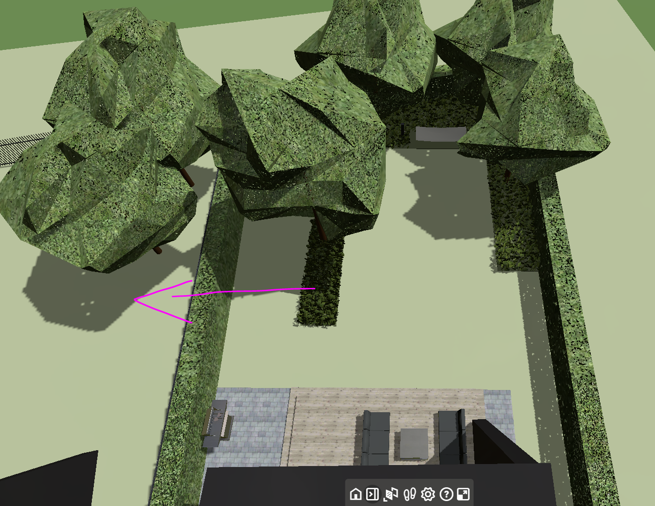

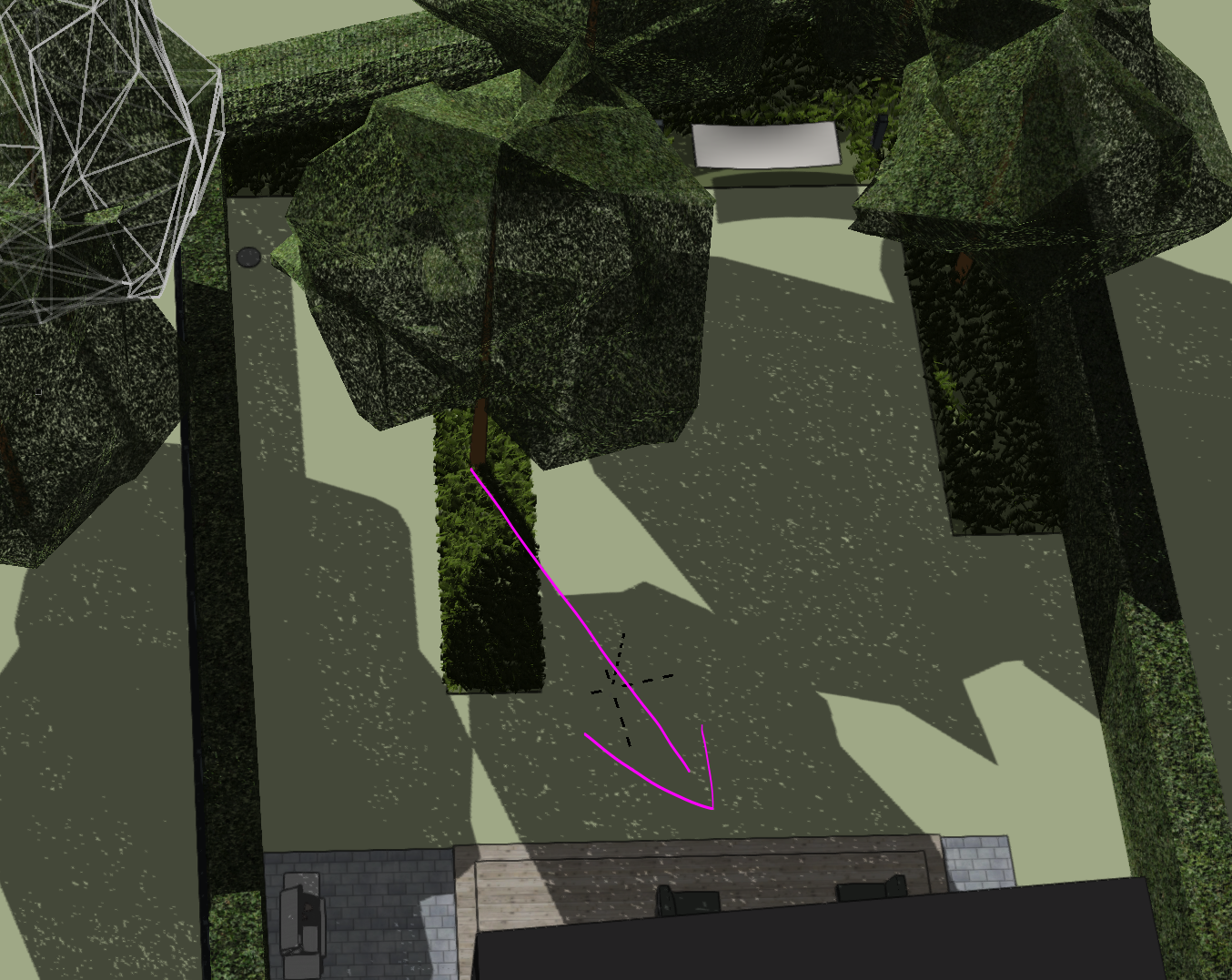

Hi, does anyone know, why sun/shadow position is off in VGX file shared in cloud?
During export Heliodon tool is on and North position set, but it's totally off in could. I can not find how to fix it.
I don't think the lighting in a VGX file is linked to lights in the VW file.
VGX has its own lighting system; use the settings to adjust the "sun" in your VGX file.
I don't think the lighting settings are "sticky" either; they reset for each viewer and each time you view the model
I believe improved lighting is high on the list of improvements for VGX files in future releases.
