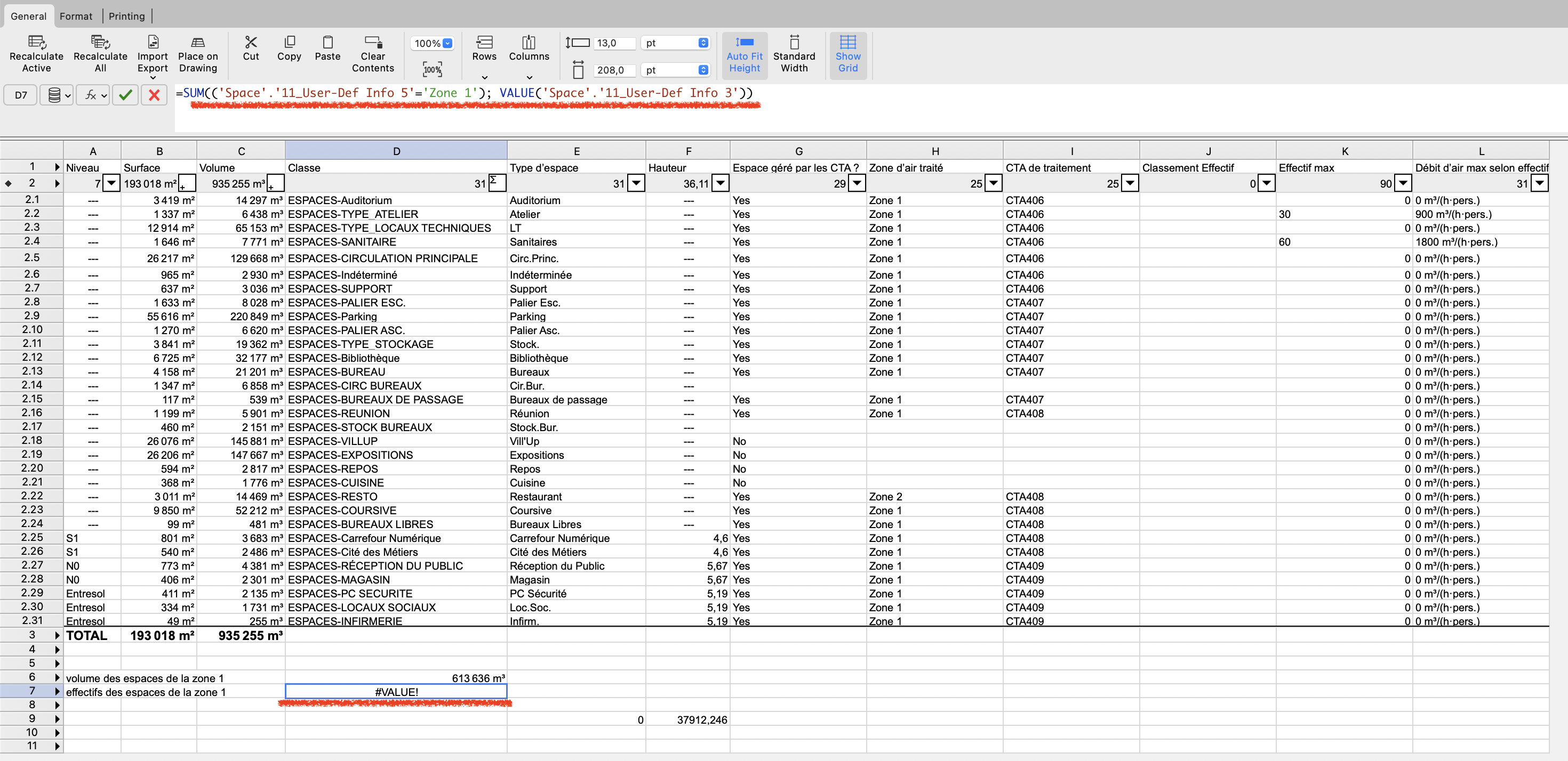

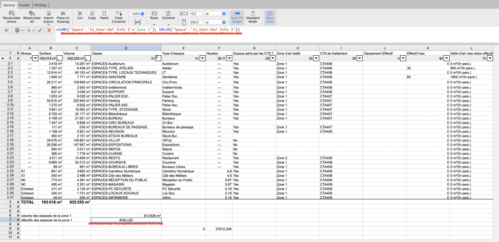

Gaëtan R. Posted November 21 Share Posted November 21 On 11/16/2022 at 11:45 PM, Pat Stanford said: =SUM(((L='Design Layer-1') & (C='My Class')), your column H formula here) should work. Hi, I tried this and did not managed to get it working. Are you sure that the SUM function can have criteria ? Quote Link to comment

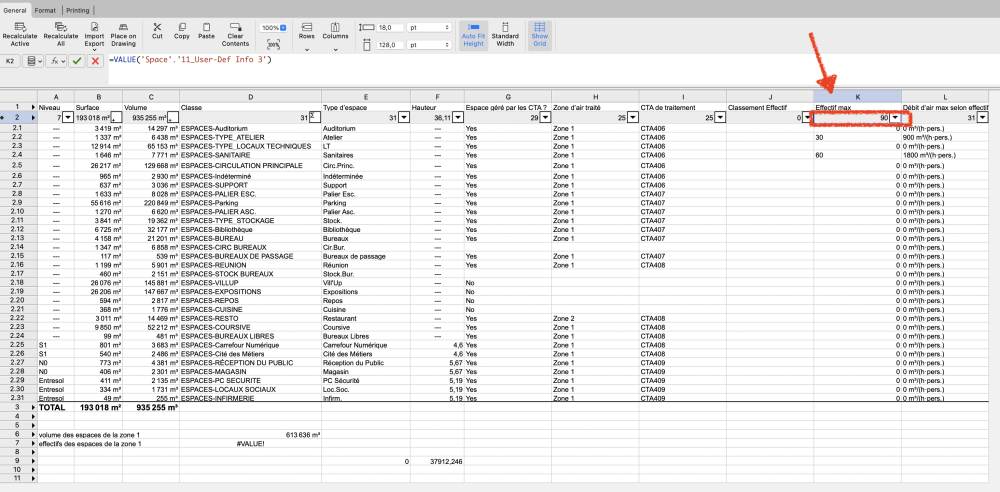

Gaëtan R. Posted November 21 Share Posted November 21 @Pat Stanford I’m trying to get the result of the database cell K2 in a simple cell D7. I tried =SUM((Criteria),(formula)) , but it does not work… Do I do something wrong ? Quote Link to comment
Pat Stanford Posted November 22 Share Posted November 22 You should be able to access that value by just using a cell reference of =E2 Unless you are trying to use it in some kind of circular logic where that value will impact other things in the database. In that case it will fail. I don't think that SUM is one of the worksheet functions that accepts criteria as part of the definition. It should be. 😞 Quote Link to comment
