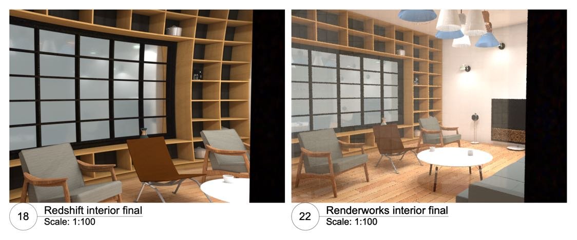

I came across your post when I ran into a similar issue, except even more extreme.
I have a few render files set up for when I am trialling new machines, to see how they compare in terms of render speed. In one of the setups, the views is through a glazed sidelight into a room, and below is the result of those renders. Bear in mind that these are the same viewport, the only difference is the render style.
I do hope there is a solution to this, but for now I am staying away from Redshift.
Hannes
Link to comment
  • 0
Check out this thread about Redshift Glass: I think the consensus is that Redshift calculated the index of refraction differently than Renderworks,
There are a couple of options listed as workarounds.
Ideally, we wouldn't have to recreate a texture to be Redshift specific, but that looks like the case with the glass shader.
