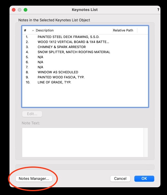

Is there a way to create a printed version of the notes database? I have developed a fairly extensive but organized database divided into drawing type sections as well as keynotes and general notes. The architect I work with says it would be much easier for him when creating redlines if I could print a hardcopy of all of the notes in a section. That way he could just mark out the notes we don't need, edit the notes that need various edits, and write in the notes we need to add. I agree with him because it is way easier for me when adding general notes or keynotes to a drawing if I have a list of what he wants shown.
If a particular section is short I can go in and create a list using the general notes tool, but if it is long this becomes really time consuming.

The Notes Database actually consists of a couple of text files depending on how you have it set up.
The files that come with VW are stored in:
Applications:Vectorworks XXXX:Libraries:Defaults:Notes.
The same path but to your User folder and/or Workgroup folder may also have files in them.
The default is two text filed.  Callouts.txt and General Notes.txt.  If you have created your own database they may be called something else.
In these files each note is on a separate line as one long text string proceeded by a Note ID number.
If you import a copy of those files into a word processor, with a little judicious Find and Replace and formatting you should be able to make a printable version fairly easily.
I recommend that you don't try and edit the text files directly, but rather use the Notes Manager to actually make the changes.

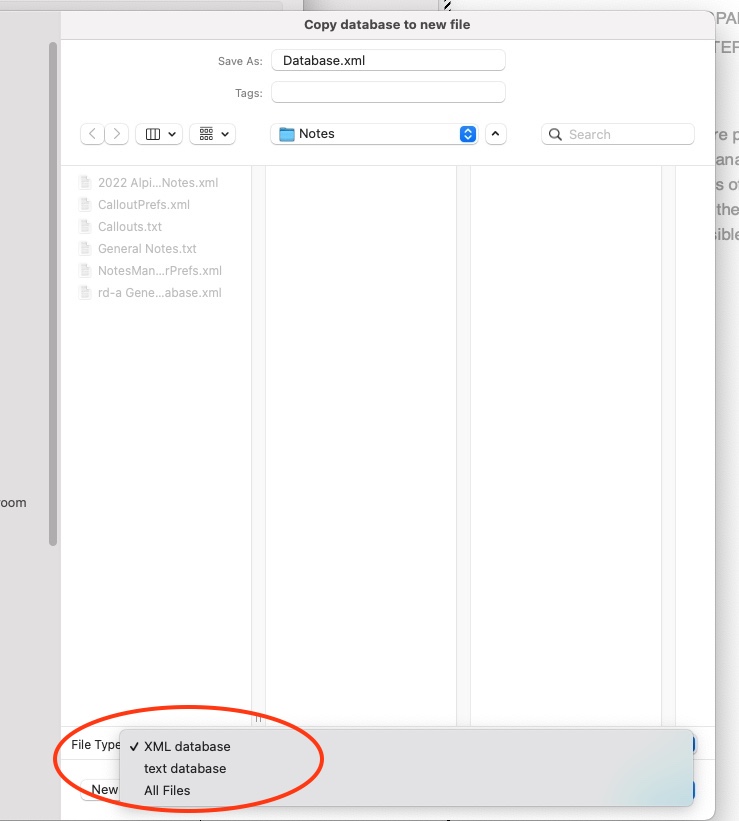

I'm not sure why, but you can have Note databases as either .XML files or .TXT files. All of my Note Database files are also .XML files. (Maybe the .XML files were migrated from an old VW installation?)
(EDIT: It looks like the Callouts and General Notes in the VW Application Defaults folder are .TXT files.)
Not sure why VW uses both file types for the same functionality...
On MacOS you can open .XML files with Apple's TextEdit app. Just right click on the file and choose to Open With TextEdit. (Using TextEdit is MUCH safer than opening it in MS Word or Apple Pages, as both of those could add formatting to the .XML file that could break its functionality).

If you want to convert your .XML Notes file to a .TXT format version, using the VW Notes Manager open your .XML version and do a Save As to a .TXT file type.
I'd love it if someone from VW weighed in to say if we should be using .XML or .TXT for our Notes Databases - whether one format is more future-proof than the other. Maybe this is a question for @Matt Panzer

@Dick Jenkins I have been using an .XML version of my Notes database (which I had Saved As from the VW default .TXT version), so I cannot say definitively that the .TXT version will work the same.
I know that the VW-provided generic Callouts Notes file inside the VW application folder are .TXT file format, so I would think it *should* work the same as the .XML version.
I’m very wary of changing anything VW-related in the middle of CDs… maybe do a quick test on a copy of your working CD file to see if it will work for you.
