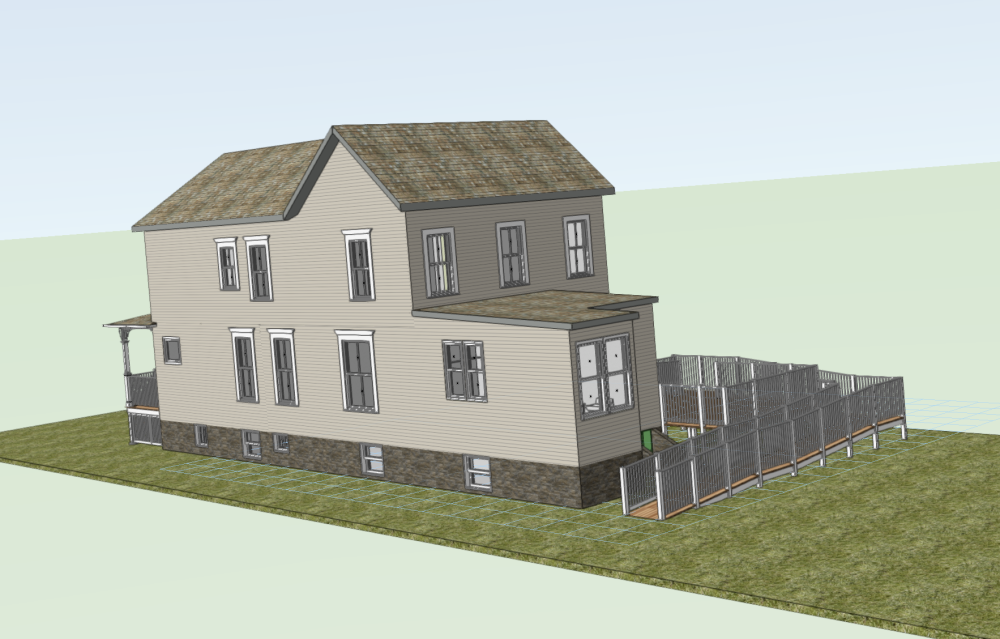

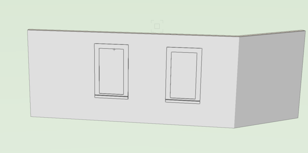

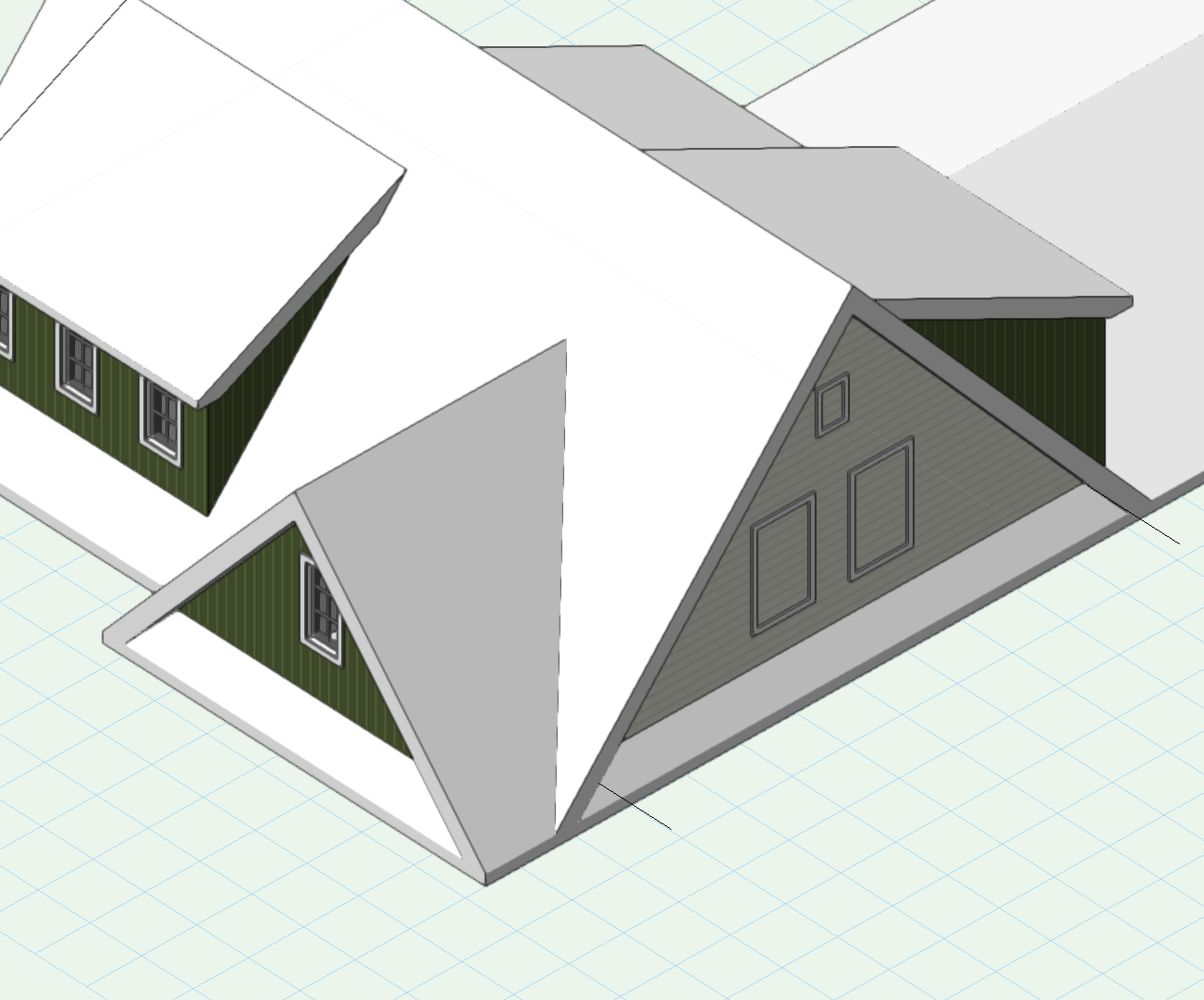

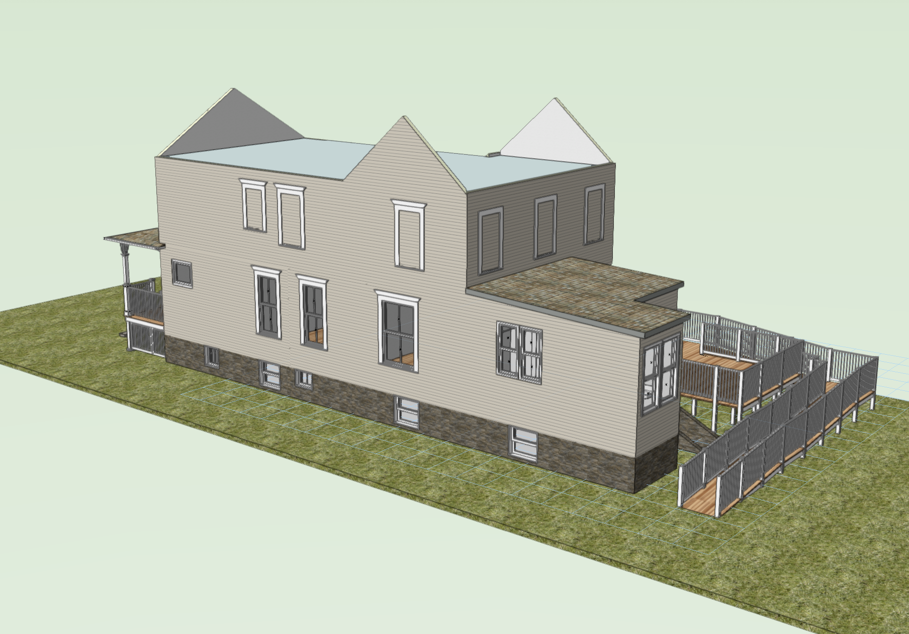

Midehow Posted September 30, 2022 Share Posted September 30, 2022 Hi, I am running into some issues after upgrading my Vectorworks from 2022 to 2023. I am trying to lower the ceiling height on the second floor. The roof disappears and the windows/ doors are no longer opening when I try to lower the ceiling. Even when I try to insert the windows back, they won't open again. Another thing I noticed is that I can no longer add more than one window to a wall section without the windows being closed. I added some screenshots so hopefully someone can help me. 1 Quote Link to comment
fabrica Posted October 1, 2022 Share Posted October 1, 2022 sounds related to this: (the workaround is to select the wall and move it 0,0 - this will regenerate wall) Quote Link to comment
