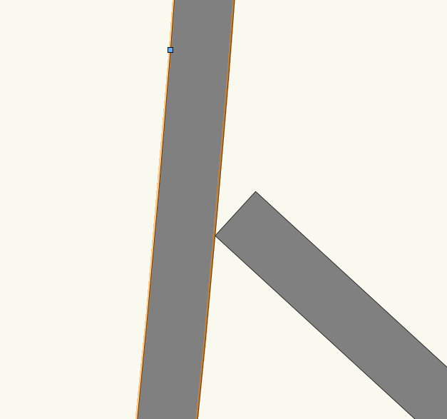

  5. We have an issue with one of our VW2026 model files. The issue is that every time anyone tries to activate the Curb tool, this instantly causes the file to crash-close. This happens across multiple machines, so the issue seems to be something in the file itself. In trying to diagnose the issue I've so far tried: 1) turning off all classes in Apply Send to Surface by Class for each Curb Style in the model. This has sorted out the 3D curb paths which weren't looking too healthy 2) Editing Curbs so there aren't any curbs crossing in the model. This means leaving odd gaps where curbs don't meet at 90 degrees - (Not being able to cut curbs at an angle is less than ideal - I and others have raised this as a feature request for some time now. I'm not sure if/when this functionality will be added but this is another issue!) I don't know if (1) or (2) could be the cause of the crash-close issue when activating the curb tool but they felt like reasonable fixes to try. However the issue persists. Has anyone else encountered this kind of issue? Does anyone have a fix or ideas for other things I can try to resolve the issue? Many thanks

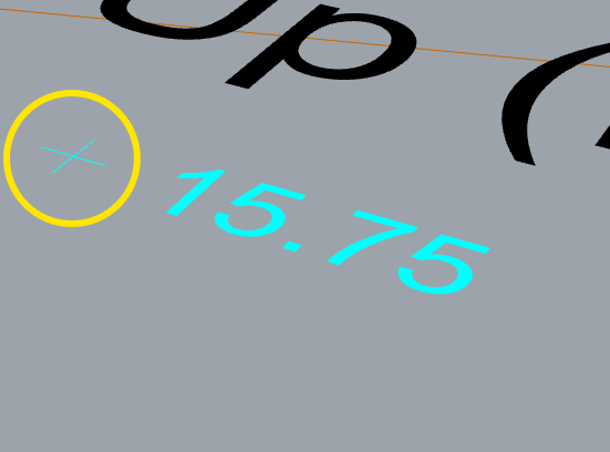

  7. We regularly encounter the following issue when importing topos - Spot heights in 3D topo surveys we recieve are generally represented by block instances. These are generally simple crosses made from two lines - We can open 3D topo surveys in Autocad/Rhino and confirm that these spot heights have the correct z-value (15.75m for the example above). But when we import the 3D topo dwg into Vectorworks, VW converts these blocks into symbols which are all at z=0. i.e. VW unhelpfully loses the z-values of all the spot heights when importing 3D topos. I can't find any import setting to avoid this 'flattening' of the spot elevations. Our workaround for this is to open 3D topos in Autocad/Rhino, update the spot height block instances to contain only points, then explode the blocks. Then when we import into VW we can tell VW to convert these points to 3D Loci, thus retaining the z-values of the spot heights. We want these spot heights to generate a site model. Am I missing something with this? Is there a better workaround for this in VW itself..? Thanks

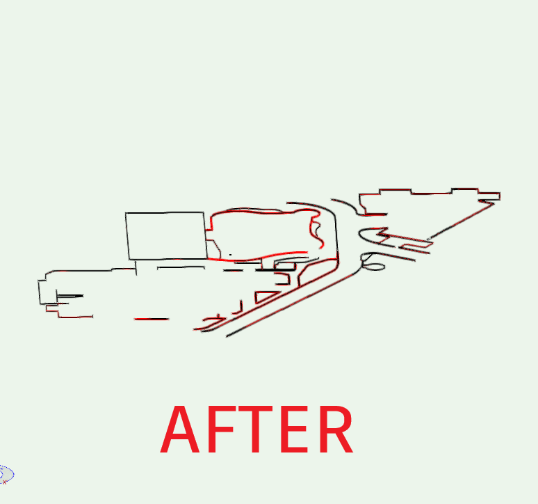

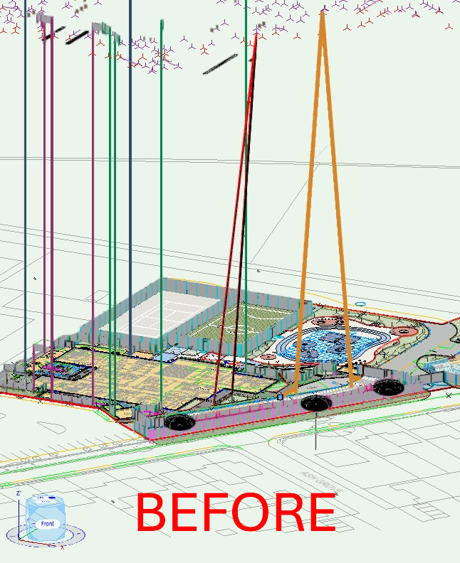

  9. Possibly not much help but - Is this issue consistent? I.e. do you experience this issue 100% of the time when importing georeferenced dwgs or just some of the time? I ask because I have occasionally experienced exactly this bizarre and exasperating behaviour in VW2025...

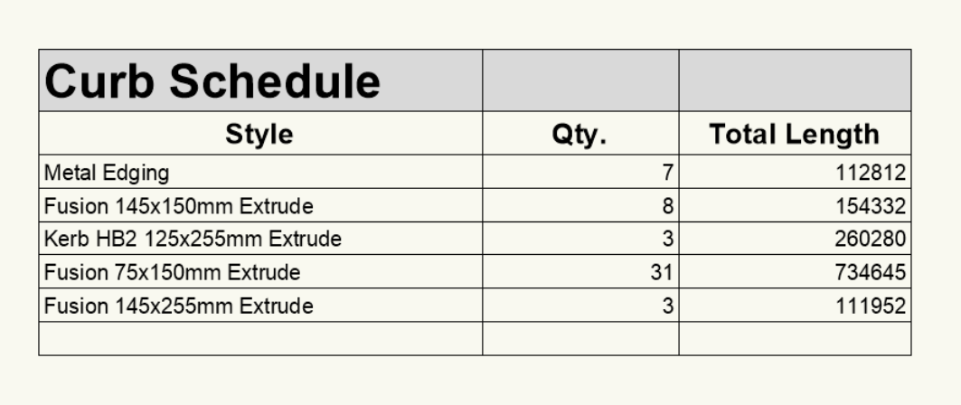

  13. I'm pulling quantities out of a model. For Hardscapes and Landscape Areas I can use the Select Similar tool with class and object type to select all instances of any particular Hardscape/Landscape Area type and the OIP gives me a total area - handy. But for Curbs the OIP will only show me the length of a single curb instance. No combined length if I select more than one curb... Would it be useful to add this functionality as a quick way to add up curb lengths? Update - Adapting a Fence Schedule didn't take long and means I have a fast way to update quants if there are design changes -

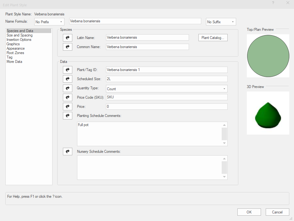

  14. Ah! Many thanks - I had looked there but hadn't checked the Fields Visibility list! I look forward to exploring planting design workflows in VW2026 at some point soon
  15. Many thanks for this @Tom W. It's odd this is where I would expect to find it but I can't see it! - Any idea why this field isn't showing up and how I can get it to show up..? Many thanks
