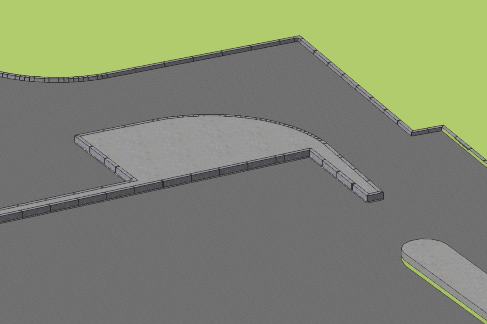

Fit Walls to Curved Objects - BUT limit height
Michael Siggers replied to Michael Siggers's topic in General Discussion
Hi @Pat Stanford So, correction due. It does work. Initially I had the end of the wall slightly embedded in the concrete dome. Moved it away slightly and now works ok. Thank you. Mike -
Ah, finding it can not be bigger than the dome as the wall flies up to this, ignoring the actual Dome. Both Dome and Temporary Slab on the same layer. Attached is a screenshot showing after fitting to objects. Mike -
Thank you @Pat Stanford That's a great Idea! Simple but great.! Kind regards Mike -

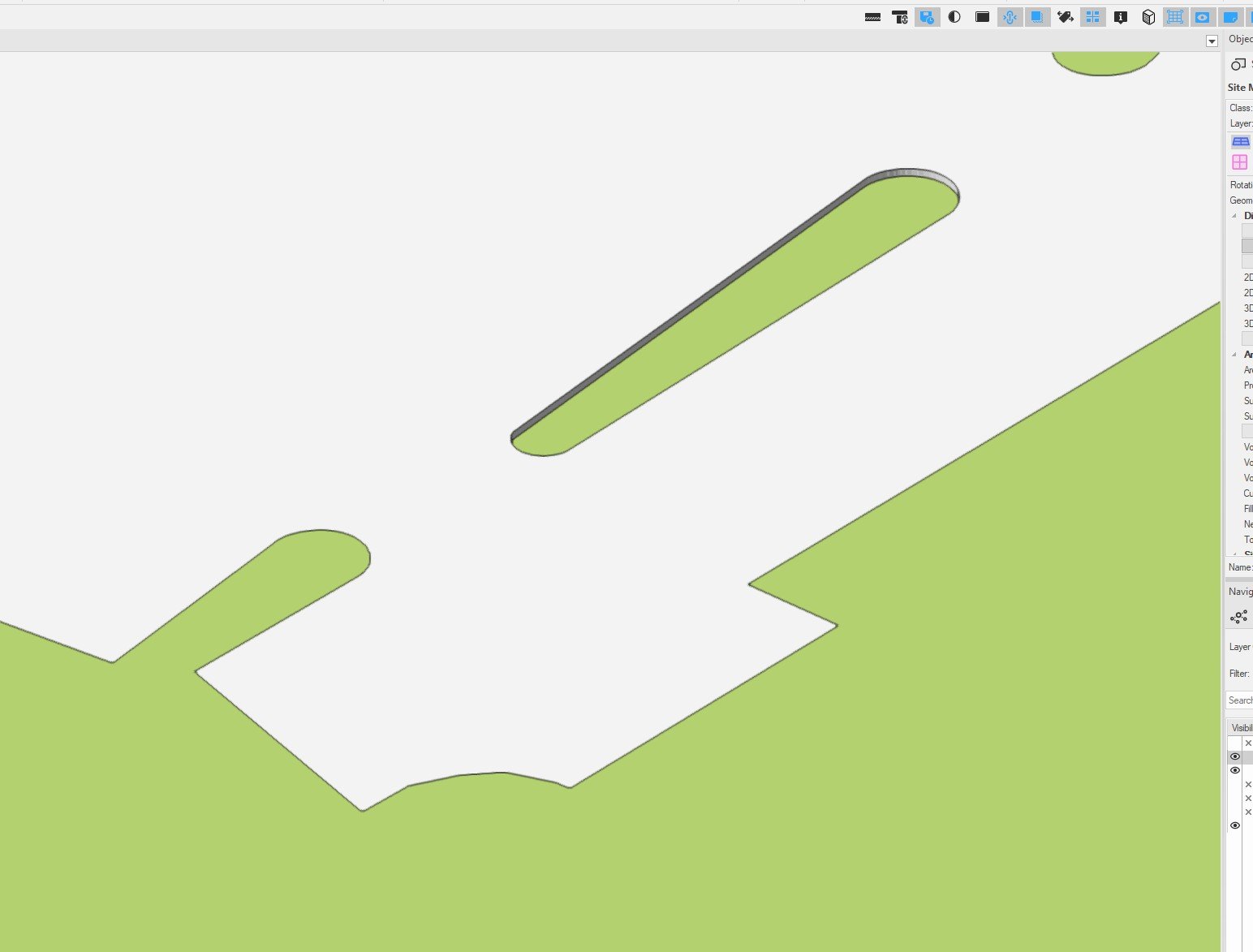

Hi I am working on what is probably the most pain in the a**e model at the moment which is made up of curved and domed elements. Within the dome, I am using the Wall tool to construct the walls. The partition walls do not go up to the top of the dome, only to 2400mm. The initial approach was to draw the walls, constrain the top to a Layerless Level created in Stories, then use the Fit to Objects to fit the ends of the walls to the dome shape. This worked, to fit the wall to the dome shape, but it did it for the whole wall and disregarded the 2400 height limit. I was hoping it would only fit the bit below 2400mm and stop when the height of the wall is 2400mm. The only solution I managed to come up with was to; Fit the Wall to the Dome shape, using Fit to Objects, Draw a Rectangle on the face of the wall to a height of 2400mm, Create a Working Plane aligned to the wall, Add a 3D Loci where the rectangle intersects the wall and curved surface of the wall, shown by the green blob, In Top/Plan view, Split the wall into two, Select the inner part of the wall, Remove it's top Peaks, Restrict the height of this wall to the Layerless Level, 2400mm Attached is a screenshot showing the result. Is there a better way of doing this? In an ideal world, I would like this wall to be one wall and not two. I was hoping the Fit to Objects would respect the height limit on the wall. Kind regards Mike

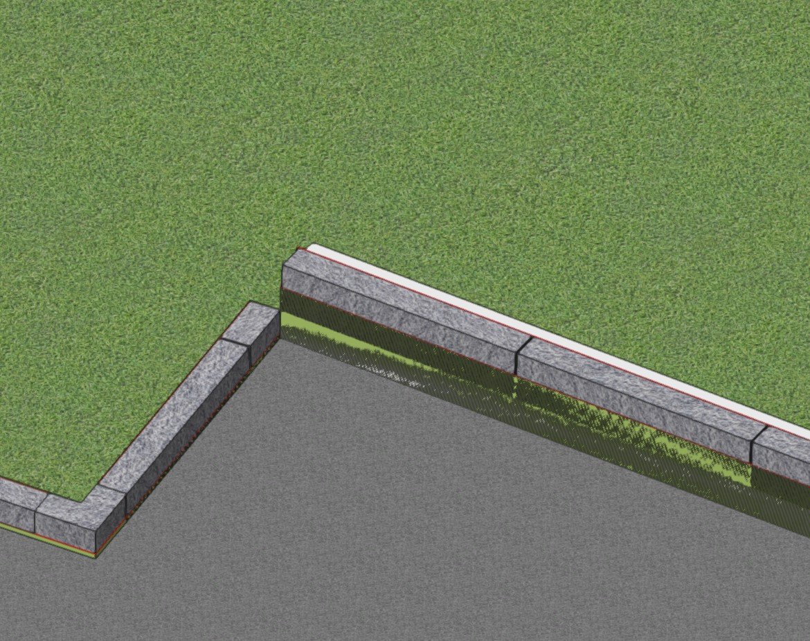

Hi Attached is are a couple of Screenshots to hopefully show what I am trying to achieve. I have also attached the VW File. The overall model has been issued to me in Revit Format, based on a LiDAR Survey by the Client. As can be seen, I think the original Architect lost his/her straight edge when designing this, or was watching Teletubbies. The dome has been converted to a Generic Solid, as will the skylights be, eventually. No work is being done to the dome or skylights, so a Generic Solid is fine. The entire concrete structure is covered in a living roof, so the skylights are hidden apart from the glass openings. Anyway, there are two openings in this 'dome', and I am trying to tidy up what has been sent to me. The screenshots are of the first entrance I am working on. Approaching this two ways; Create a new Curved Wall to replace the Revit version, (pesky Revit!!). I can do this and control the top edge using the Sloped Coping stone which is a generic Solid on the Roof Layer. However, I think trying this as a wall will cause problems when trying to create the curved opening, shown in the screenshot where I have hidden this wall, to reveal the opening, or Create an Extrusion to replace the Revit wall and then Trim it to fit the Sloped Coping stone. This is the part I am struggling with, as if I use the Coping stone to trim the Extrusion it only removes the part where the coping stone is. I should (?) then be able to create another solid to subtract to reveal the opening. So, with the preferred method being the Extrusion, can anyone point me in the right direction to be able to trim this to fit the sloped coping stone. Feel like I am pushing my limits with my modelling skills on this so any help and guidance would be appreciated. Once I have the base model sorted, the rest should be fairly straightforward........... famous last words 🙂 Kind regards Mike Revit Import Test.vwx
