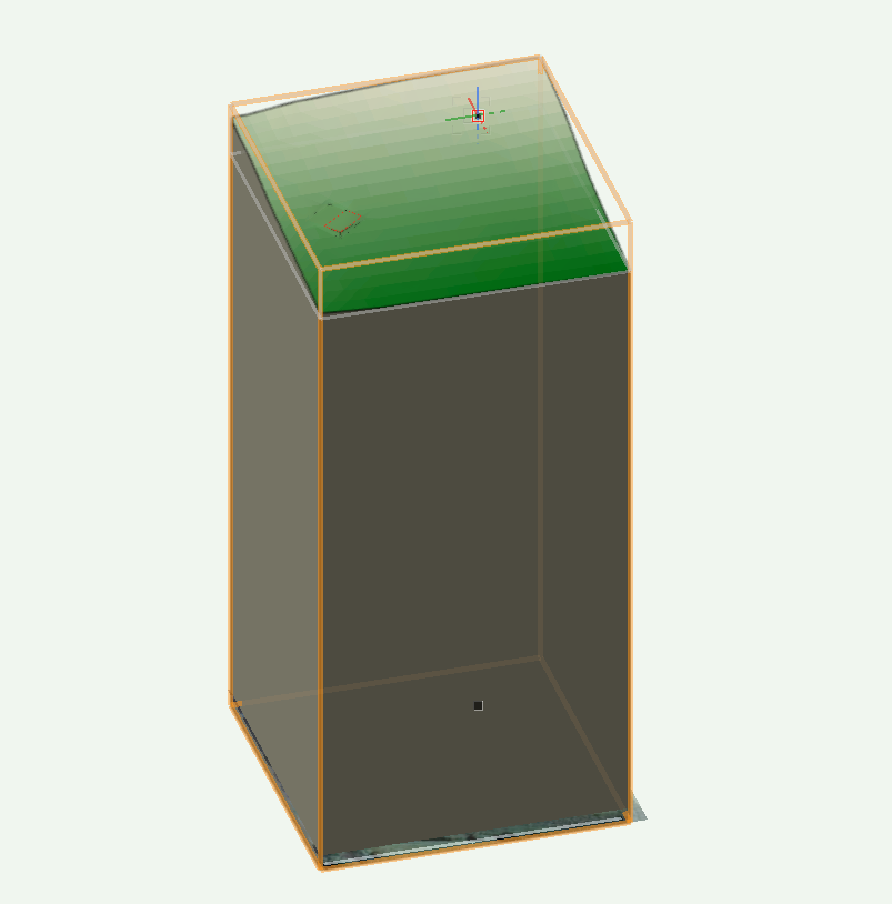

  6. EDIT: sorry please ignore me. I just found it in the Site Model settings and added a Minimum height, which was on 0. This happened to me in an earlier project and has just happened again. I now know why, because a site modifier was at Z0, but I've corrected that and the skirt is still down at 0. I can't find where to correct it, please can someone point me in the right direction?

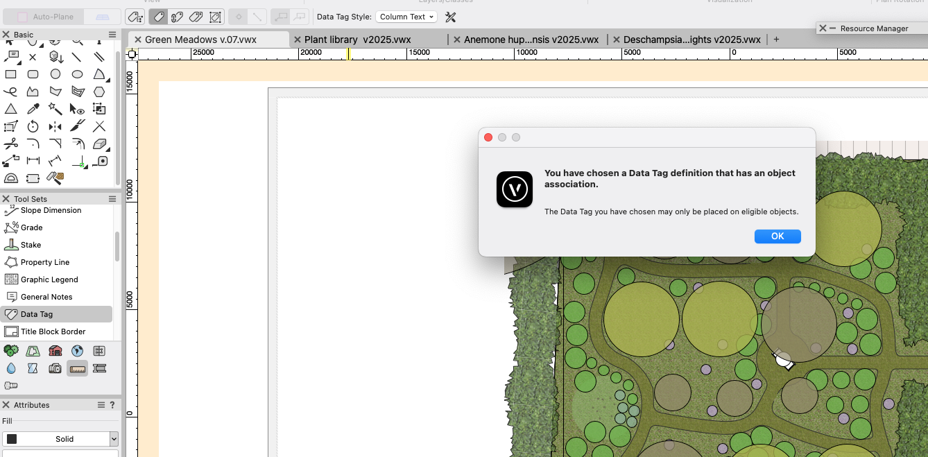

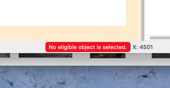

  9. I'm in the annotations of a sheet view and when I try adding Data Tags to plants, it's saying No eligible object is selected. Have I don't something silly? I've used data tags before fine, but they don't seem to be working now. The plants all have the main data fields filled in as plant styles.

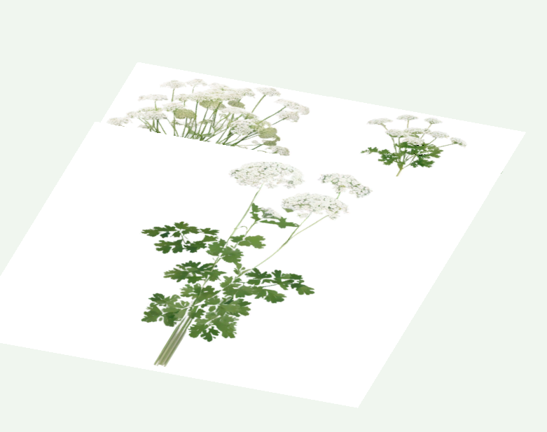

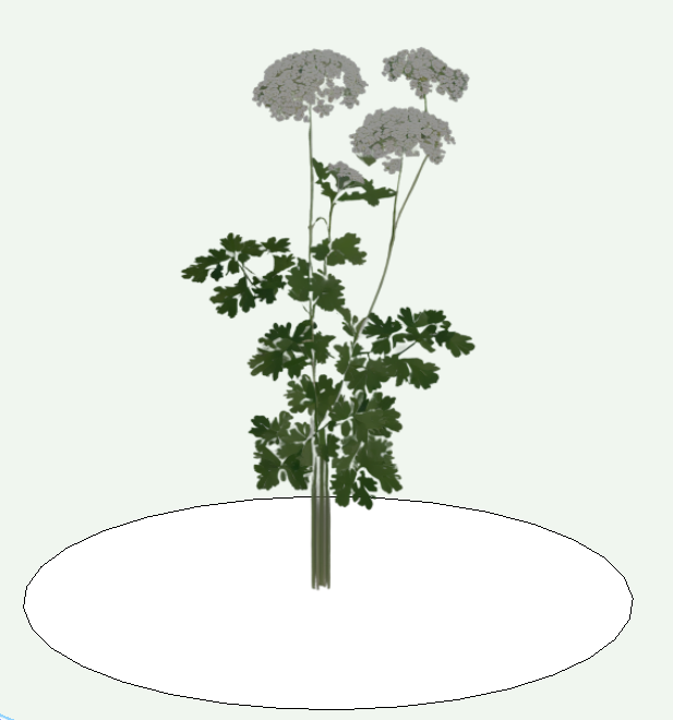

  12. Hi Dave, if I save the AI image as Create Bitmap Object, it appears in the file like this: When I then create 2D plant style, within the menus I go to Create 3D from image but I only have a couple of textures in there, I can't find the image that has just been inserted into the file. It does work if I Save to File, naming it, import the image into the file and then create the model from that. I was wondering if I can skip that, and add it as Create Bitmap Object? Hope that makes sense, I might be asking something silly. Here's a cow parsley I made from an image, which is pretty good really, although I seem to have too much shadow on it - I haven't found any umbels on Globeplants or elsewhere yet. The leaves are more parsley like, and I've still not cracked how to generate the base of plants well. But overall, I can imagine this tool be invaluable soon.
