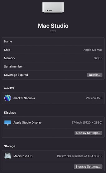

2026 texture application Perimeter and Surface UV
in Troubleshooting
Posted
I little bit of follow up
In order to check if the issue is about my original 2026 installation, i installed again on a spare laptop (Which is also Mac OS 15.5).
base install, no preference or plugin changes - Blank (Metric). Same outcome - instant crash while changing texture map type.
