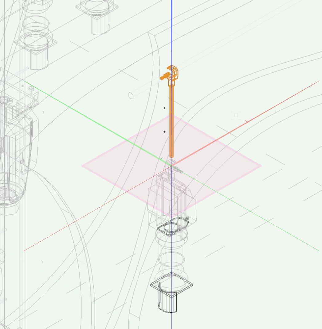

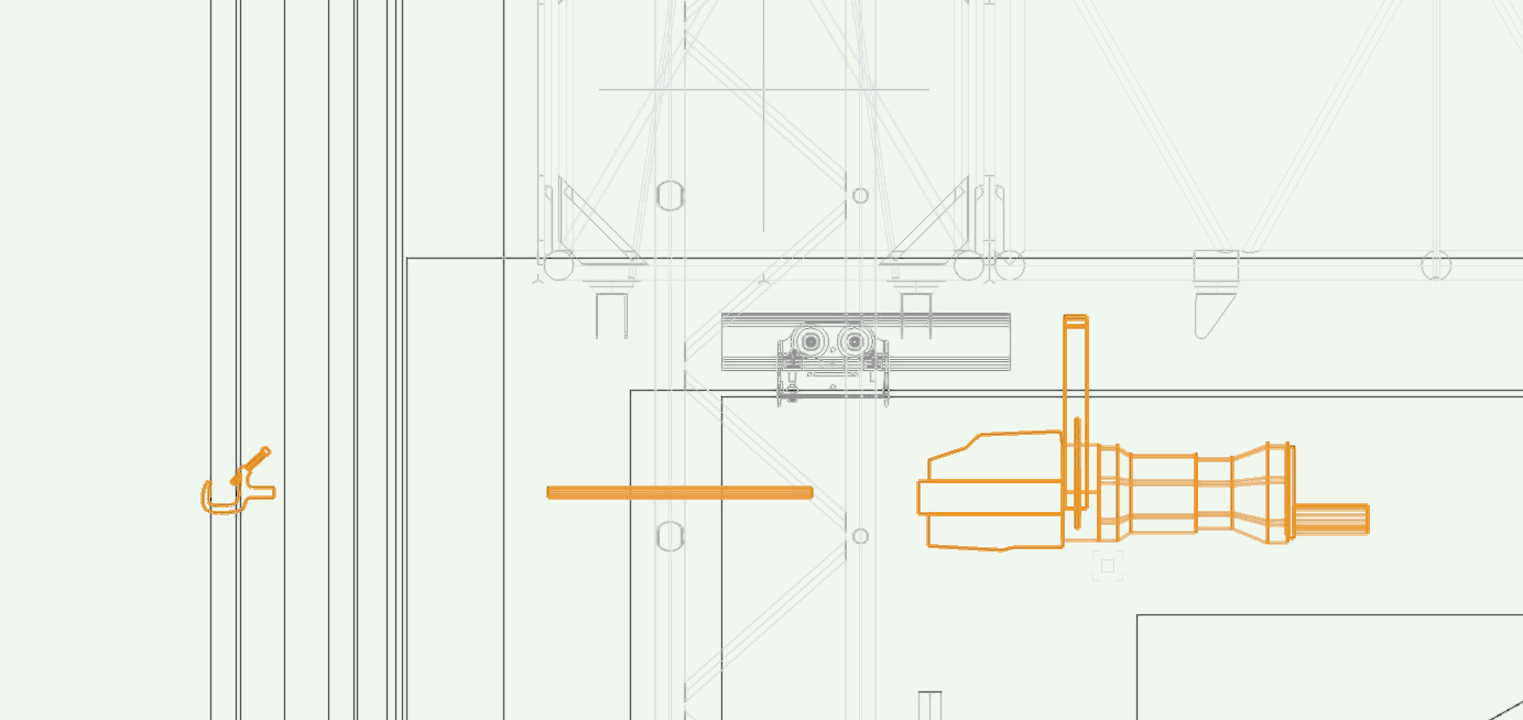

  2. @markdd Yes, this is almost exactly it. When it is added in the edit view, it shows 2d and 3d correctly, but once it is in the regular working environment, it disconnects the different pieces and seems to attach it's rotate point to the body of the light, rather than the yoke. How was the "adding" of two accessories accomplished like above?
  3. Is there a best practice for accessories attaching to the yoke of a fixture? I'm having trouble creating a taildown and it looking correct in 3D. When I edit the accesory, it looks correct, but when I exit and look in 3D, it detaches the clamp from the extrude and moves with the focus of the fixture. What am I missing here?
