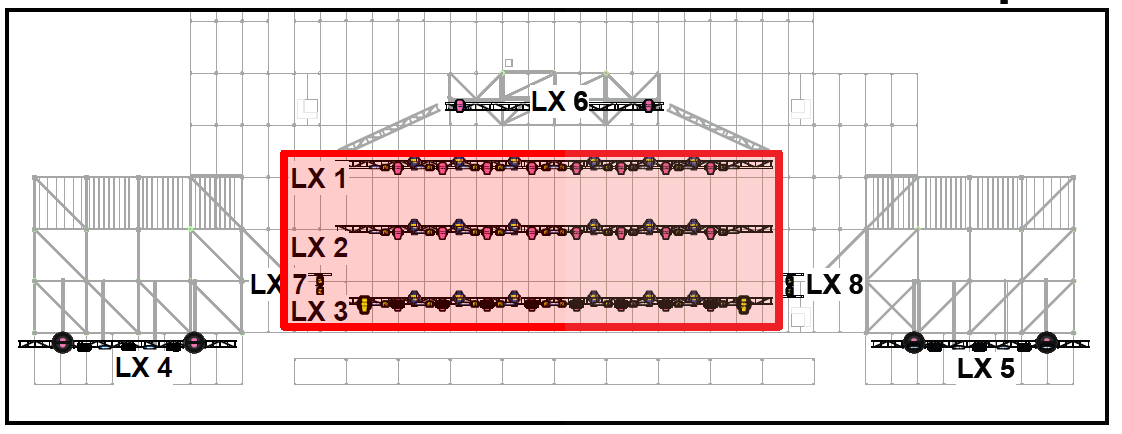

Is it possilbe to put a viewport to multiple sheet layers, or reuse the same viewport object? When copying the viewport from one sheet to another this makes also a copy of the viewport. So now i have two identical viewports in the list. If i now want to change them i have to do it manually or by copying and pasting. This is not so much work if the viewport is without annotations, but if it contains annotations and i want to change the crop, this becomes very time consuming. Example when making sheet layers, i want to have an viewport with an "Overview/Map" at all pages, and use annotations to highlight the area of this actual sheet layer. Is there a better way of doing this, or can i add this as an future request? Example here of what the map could look like. This will typically be small into one corner of the sheet layer.
