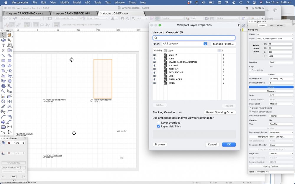

  3. Hi Pat, Thank you for this. I did this from both OIP and Organization see attached. All classes and layers on on both and still see nothing. Like I said I have had this problem before and cannot remember how I resolved it. A few things: I can see NEW viewports if I create them All viewports are on "none" class (Lazily) I imported a few DWG faucet/tap supplier files directly into the drawing and they had viewports and I'm wondering if this somehow modified the properties of the other None of the other drawings I have open are affected It may just be easier to redo the 165 viewports. Sam
  4. Hi Everyone, This is a basic question - I know as I've asked before and completely forgotten how to fix it. See attached the issue with my viewport not displaying content and the Layer Options stuck on Active Layer greyed out, so unable to be modified. I know I need to unlock this somehow but can't remember how. Thanks for your help!
