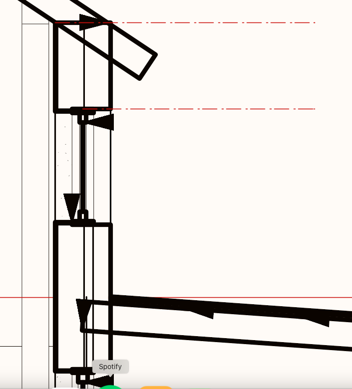

Weird Arrowheads showing up on my Section
in Architecture
Posted
Thanks so much - I would have NEVER figured that out!
