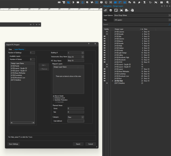

On 12/4/2025 at 9:32 AM, Henrique Lauer said:
It seems the missing layer are already assigned to Vectorworks Story Name - Site. If you change the, "Vectorworks Story Name" dropdown to Site, you will see the other layers.

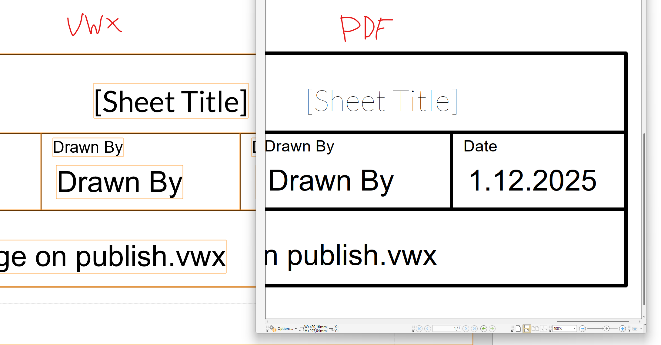

12 hours ago, aheininen said:
Hi
Windows 11 25H2, Vectorworks 2026 U2.
@aheininen Sorry, another question. May I ask where you sourced the Lato font or could you provide us with the font? We would like to download and/or test with the same. Sending as a private message if okay too.

4 hours ago, aheininen said:
Hi
I'm getting this with Lato font. Lato (regular) changes to Lato Hairline. Arial on same Sheet Layer is not affected. Here I have used stock Simple Title Block 01 style from Vectorworks Library in blank document.
VWX ja and PDF files attached.Text on sheet layer is also affected, viewports and viewport annotations are not.
Sht-1-Sheet Title.pdf Title Block font change on publish.vwx
@aheininencan you confirm what operating system you are using for the bug report?

I'm going to submit a separate bug for the most recent mentions (Tekton/Lato fonts) and link it to the original (Arial Font changing to Italic) bug I submitted previously.
I'm seeing Futura changed to Italic also when exporting to PDF on the Mac and opening in Acrobat Reader. -
