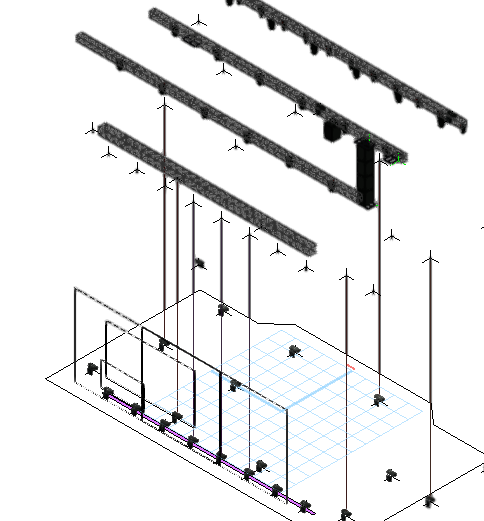

'Select Truss System Objects' doesn't select all truss system objects.
Scott C. Parker replied to Ben Garcia's question in Troubleshooting
The arrays don't highlight because they don't have a physical connection, but we know they're connected, and that's why they move when the truss moves. Why it doesn't highlight, I don't know and I'll ask the programmers. As for the hoists, if you change to an ISO view, you'll see none are connected. They're all landing on the floor. Once I move one to the truss, it highlights. -
